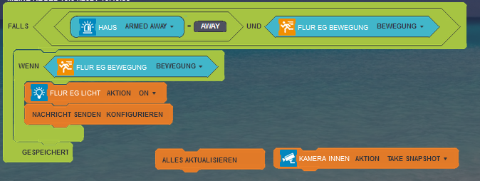

Can you share a screenshot of the rule that takes the snapshot and sends it?
yes of course. I use this one:
/c3b6b8e1c830bf21afdd01e185c3735c
I already tried to place the "refresh all" or "Take snapshot" Block before the "Send message" Block, but without success to get a fresh snapshot.

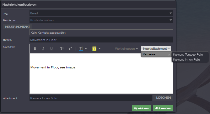

See below the message settings. But as I am saying basically it works and I am receiving a snapshot. It´s only not a fresh one =)

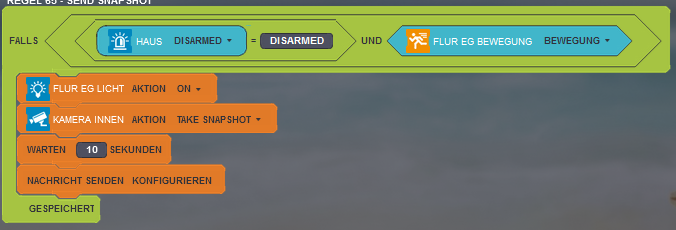

Wow. It works indeed perfectly. The snapshot is performed exactly when the movement is recognized!!!
Vielen Dank!!!
Here the rule:
/ce4debebb19762f91775f9e317b8d3a1
PS: Ja hast recht, dass "WENN" kann weg =) Habs aus meiner größeren Regel einfach rauskopiert. Vielen Dank für deine Hilfe.
