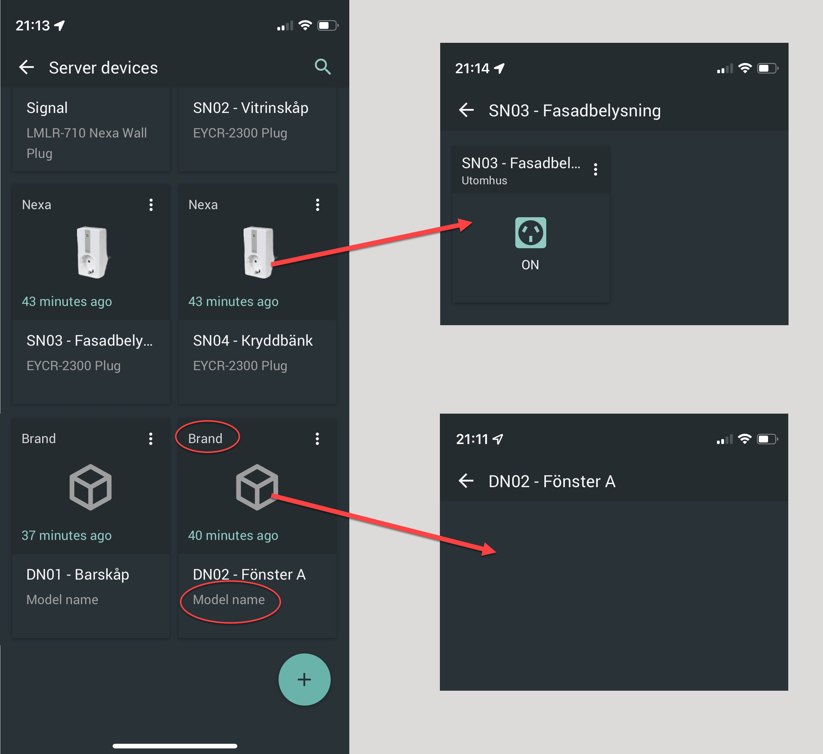

Just updated to a Zipabox2 with the new app, and are connecting my NEXA 433 devices.
It's not possible to connect devices from the app. Have to use the webbsite to connect 433 devices.
My Dimmer Wall plug (EYCR-201) want show in the mobile-app and I can't set the lightvalues.
In the app Brand and Model name isn't showing as well.
My On/Off Wall plug (EYCR-2300) are showing up in the mobile-app and is working.
Am I doing anything wrong when registrating the units or whats wrong?

Hi.
I had ticket open for this. Resolved today and device control is now working.

Thank you. I can see the devices now in APP, but I can't control the devices from the APP. Light is off even though the app says any other lightlevel.

Hello again Janne,
After restarting the app it worked with control of devices.
