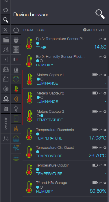

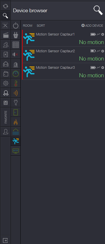

I have installed my Fibaro on my Zipabox zwave module
I can see it in the admin panel but as you can see, there's "No motion" displayed. And i can't activate it (or i don't know...
And, of course, i don't see any motion detection.
Could you help me ?

Yes i change the battery 3 days ago and re incluse several times 😢 always the same problem

Can you still retrieve parameter values? Could you please check the parameter for sensitivity and if it is configured properly?
Sometimes those devices need to be triggered a couple of times to finally wake up and start responding.
You may try to do a Z-Wave Reset, reboot the ZipaBox afterwards and then try to add the device.
Also, make sure that your Z-Wave antenna is plugged in properly.
