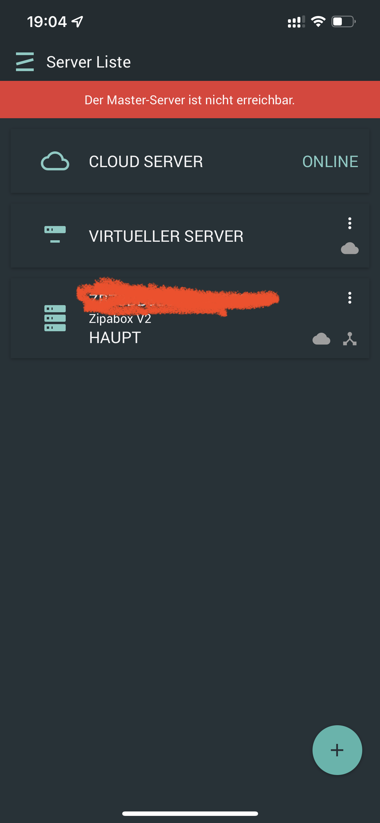

My app shows this "Master server is offline". Green LED is NOT blinking. After restart of the system I get some status information but then again master server is offline.
What can I do?
