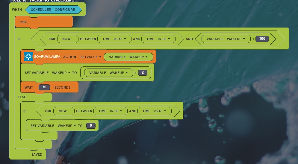

Maybe i can do something like this. It seems to work.
There was an issue with the WAIT command recently so check again.
Your setup should work fine.
