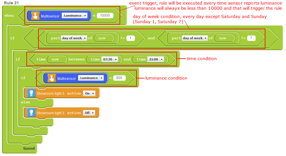

Ok,
Rule1 during Monday ,Tuesday, Wednesday, Thursday and Friday from 7:30 to 21:00 if there are less than 800 lux light should turn on
Rule2 during Monday ,Tuesday, Wednesday, Thursday and Friday from 7:30 to 21:00 if there are more than 800 lux light should turn off
Ok,
Actually you need only one rule for this.
Please look at attached image for the rule example.
OK it work!
thanks Nenad
OK it work!
thanks Nenad
