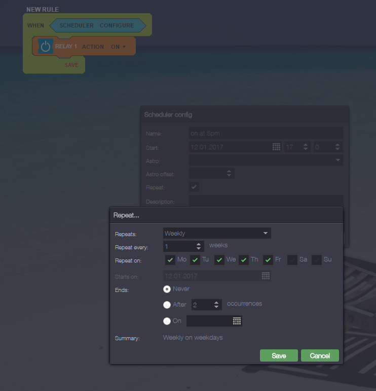

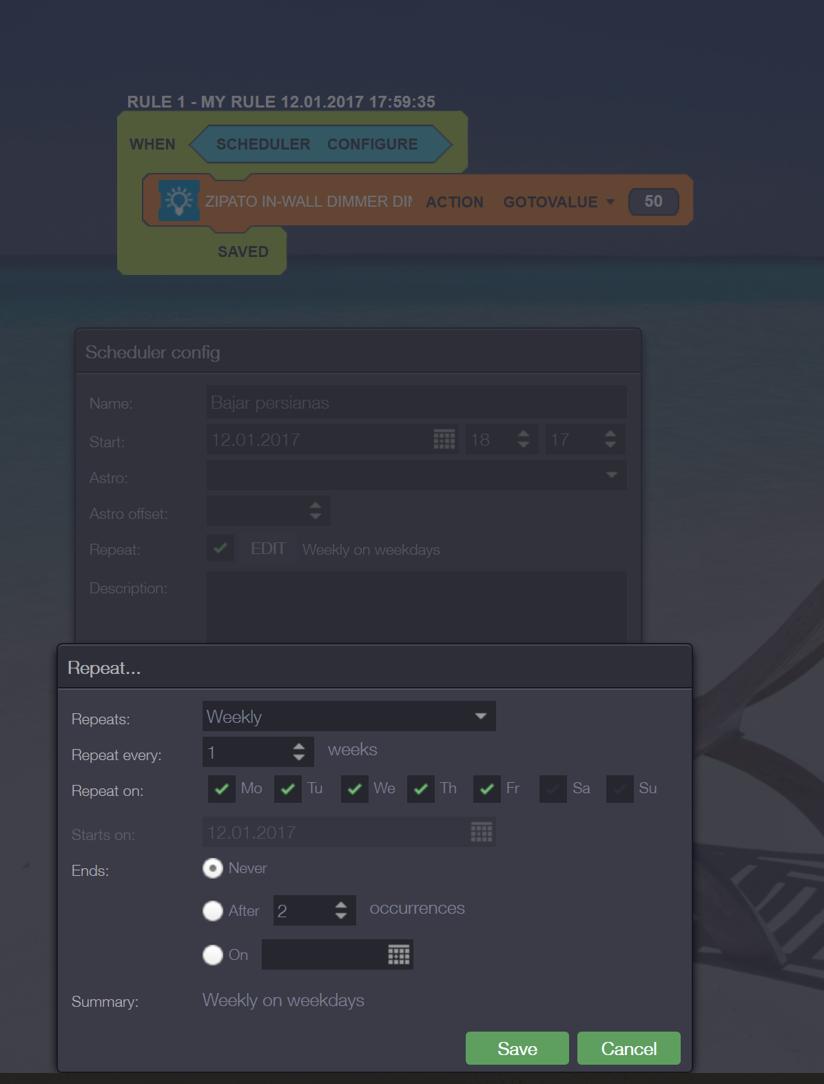

What about creating a rule to turn on an actuator monday to friday at a time and turn it off same days at a different time? I'm trying to do it with the shutters and it doesn't work and getting crazy... thanks in advance!

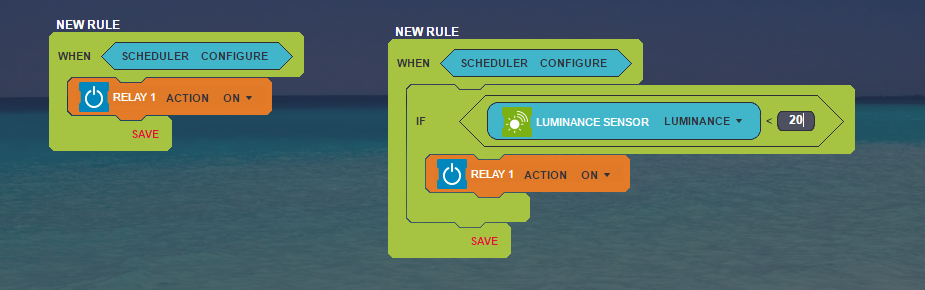

just create 2 rules. 1st rule use the scheduler to set the time and repeat days to turn on the actuator, then 2nd rule do the same to close. see "1" attached. Then later you may introduce other factors such as "2" where it only turns on if the light level is below 20.
