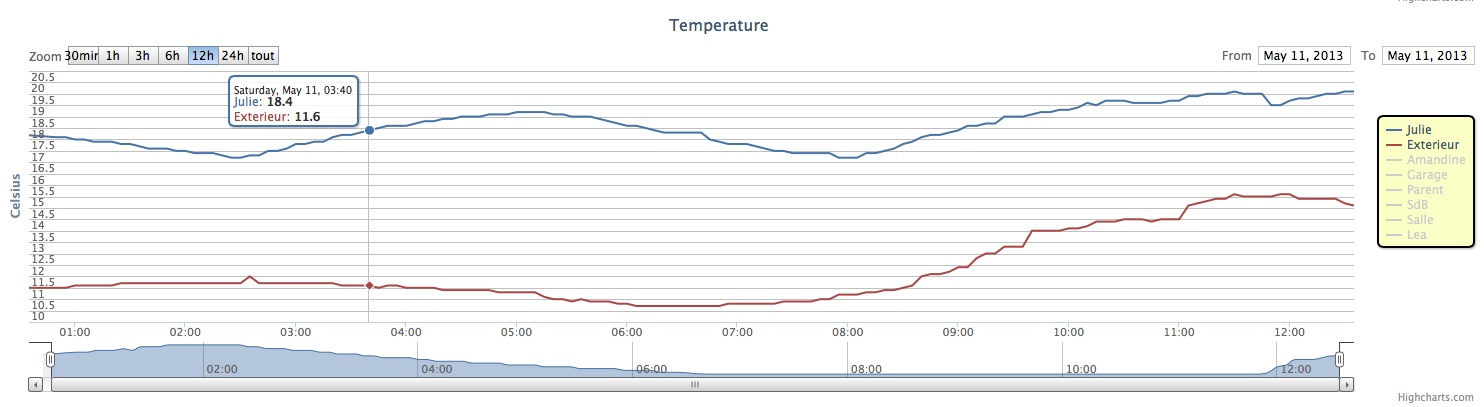

Here are two snapshots of what I configured on my sen.se dashboard.
works with agocontrol on Raspberry Pi and a single python event handler which sends data to sen.se and also to virtual devices on my zipabox.

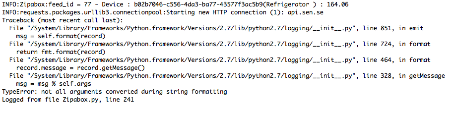

- I get an error connecting to sen.se (Attachment)
I added the current consumption, just download the last zip and replace the Zipabox.py and have a look to the config example
It was a bug in the script when there is an error during connexion to open.sen.se, it is corrected you will see the error in the logs

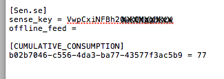

Thanks! I have now all 3 values types in the config file. Temp, accum. cons. and current consumption. But still.. For all of them it says...
INFO:Zipabox:NO FEED for Device : xxxxxxx-dc00-418a-ace6-fc5778fb07e8(Refrigerator ) : 0.50
When running the API for the same device uuid and ID it works.

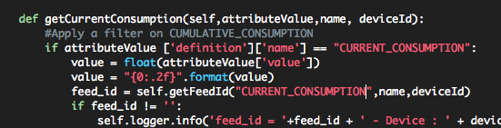

I found it! There is a bug in the section of the current consumption. Check attachment.
Now it works fine!
You're right! :) bad copye and paste.

  190. def getCurrentConsumption(self,attributeValue,name, deviceId):
  191. #Apply a filter on CUMULATIVE_CONSUMPTION
  192. if attributeValue ['definition']['name'] == "CURRENT_CONSUMPTION":
  193. value = float(attributeValue['value'])
  194. value = "{0:.2f}".format(value)
  195. feed_id = self.getFeedId("CURRENT_CONSUMPTION",name,deviceId)
  196. if feed_id != '':
  197. self.logger.info('feed_id = '+feed_id + ' - Device : ' + deviceId + '(' + name + ') : '+str(value))
  198. parametersTmp = {'feed_id': str(feed_id), 'value': str(value)}
  199. return parametersTmp
  200. else:
  201. self.logger.info('NO FEED for Device : ' + deviceId + '(' + name + ') : '+str(value))

and ini file :
    Could you please send me the code as an attachment, I will do a diff and see if there is a better solution to implement that. On this thread or by the http://sourceforge.net/users/fravetier
    I added humidity and luminance in my code, but I will publish everything with the temperature
    many thanks and great work!
    if like me you do not have a Sinology NAS, a Raspberry or another linux stuff to put and launch the zipabox conector script (i know that i am not the only one)

    - download config.ini using FTP (Zipabox password is now crypted). Update zipa id = sen.se feed Id & reupload
    - launch "python ./zipabox.py". Normaly you should see datas in Open.sen.se

    Oui je viens de voir ça, je suis en train de lire le tout, mais je bute sur un message d'erreur:
    1. Traceback (most recent call last): File "./Zipabox.py", line 7, in <module> import requestsImportError: No module named requests

    You need to create device and feeds in open.sen.se
    When you run the python script it will show you all the zipabox feed avalaible
    edit again confi.ini after first load to put
    id.feeed.zipabo = id feed open.sen
    Ahh, got it now! Super Super thanks!!

    Do you guys think this is enough graphs for 3 temp. meters :)
    5RbFSfty4nBYEOvjtrvM
    Nop but it is free

    Hello, this is a capture screen of cumulative consumption generated with 2 instances of Zipabox. That's great you modified to have it running in one instance, i will try to use it !

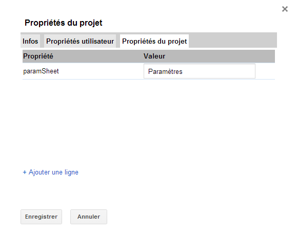

    Oh I see, you have to add a value in project properties (see screenshot) :
    File -> Project properties -> Project properties
    value : "Paramètres" => it is the tab name of params data
    I just added it in the spreadsheet so you can copy it again if you need to.

    Since One day Zipabox connector on my Raspberry does not work with following error. Please note i changed nothing in my configuration but had this problem
    of certificate error. Any idea of the problem ?
    pi@gateway ~/Zipabox $ ./zipabox.sh
    INFO:Zipabox:Starting Processus...
    INFO:requests.packages.urllib3.connectionpool:Starting new HTTPS connection (1): my.zipato.com
    File "Zipabox.py", line 379, in <module>
    zipabox.processMetersToSense()
    File "Zipabox.py", line 366, in processMetersToSense
    data = self.initLoginZipato()
    File "Zipabox.py", line 108, in initLoginZipato
    response = self.session.get(self.uriZipato+path)
    File "/home/pi/Zipabox/requests/sessions.py", line 369, in get
    return self.request('GET', url, **kwargs)
    File "/home/pi/Zipabox/requests/sessions.py", line 357, in request
    resp = self.send(prep, **send_kwargs)
    File "/home/pi/Zipabox/requests/sessions.py", line 460, in send
    r = adapter.send(request, **kwargs)
    File "/home/pi/Zipabox/requests/adapters.py", line 362, in send
    raise SSLError(e)
    requests.exceptions.SSLError: [Errno 1] _ssl.c:504: error:14090086:SSL routines:SSL3_GET_SERVER_CERTIFICATE:certificate verify failed
    pi@gateway ~
    Just solved the problem. It was due to the release of Python i had 2.7.3, seems the certificate embedded on it was obsolete. I had to update to latest release of python : 3.4 but i had to modify Zipabox.py to be compliant with latest release python because

    For the new people like me trying to integrate zipabox and open.sen.se on first time I can share a simple guide:
    On config.ini the feed id attributte must be found on open.sen.se:
    Add Channel -> Custom Channel -> Create your Zipabox Channel, then add a Feed and when you create it go the the new Feed description and inside you must see the Feed ID than have to be configured on config.ini.
