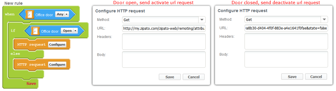

Actually for the second scenario it's very simple.
You just need to create one virtual sensor on second box (box that isn't associated with real sensor). Then create one rule on the first box (with real sensor)
which will send http requests to activate and deactivate virtual sensor.
See attached example.
For the first scenario you will need http requests with parameters or you
can create rule with a lots of "IF" conditions and http requests :)
