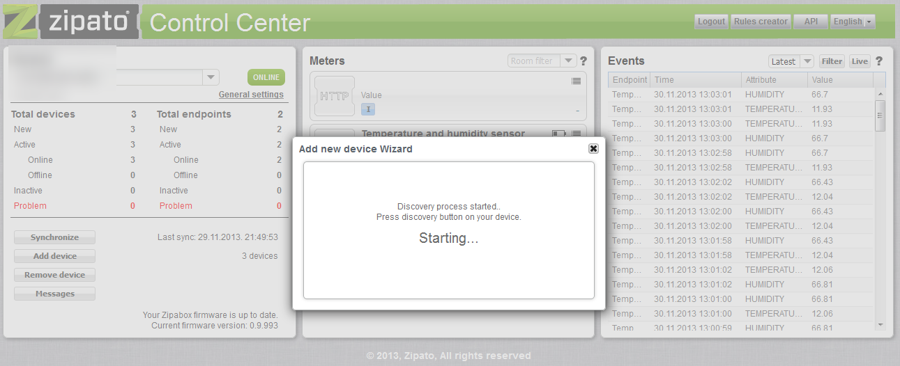

I have add a first module successfully. but now i have that problem :
It was blocked on
"Discovery process started..Press discovery button on your device.Starting"
I have try to reboot the box, test from another web browser, try to sync the box but nothing changed.
The box was always at the same sync date.
Thank you

We are looking at it already. Soon we will come back with the info...
Seems to be ok now
Seems to be ok now
we had some problems with the message queue which was causing the problems in communication between the server and the UI.
We will continue monitoring the servers for some more time...
Problem solved.
Problem solved.

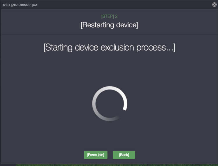

Guys,
Currently I have same exact problem.
Upgraded a new brand ZipaBOx to official ver. 1.3.13 and unsuccessfully tried to add devices. It was hanged on "starting device exclusion process" with no countdown started.
I tried also to downgrade to previous ver. 1.2.41 with same problem.
I'll appreciate your prompt reply.
Thx,
Avi
