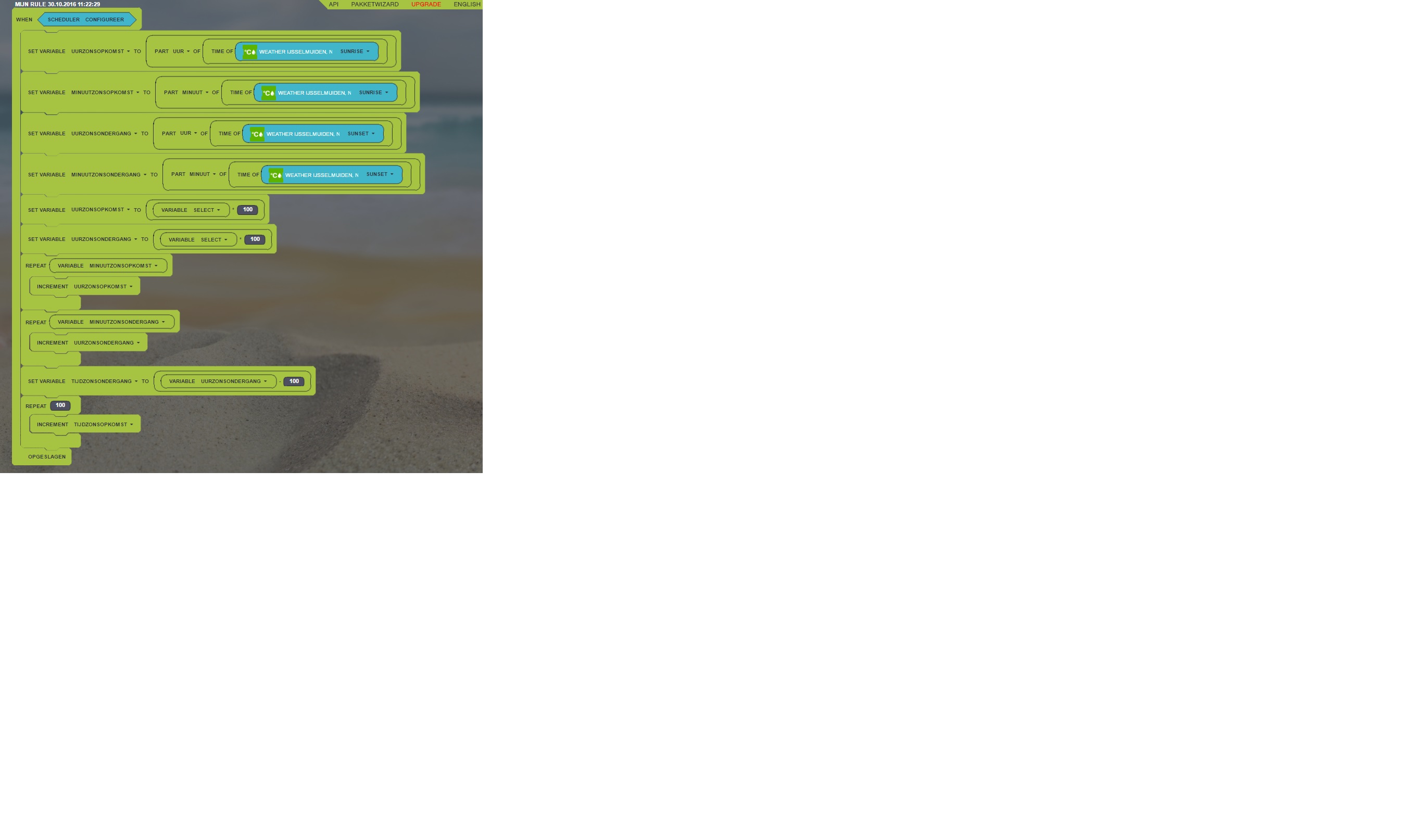

I think I have it working. I wanted to have a rule activate a light between one hour before sunset and one hour after sunrise. I created to variables for that that get populated in a scheduled rule.

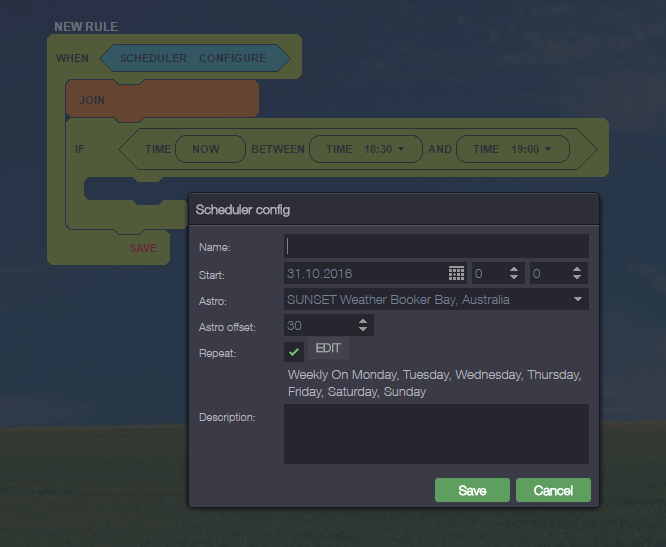

use the astro offset in the scheduler, +30. This will trigger teh scheduler 30 minutes after sunset. Then you can compare this to the time now.
