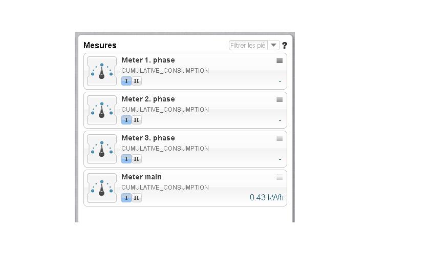

My Aeon Home Energy Meter DSB09104, is connected to my zipabox, i can display only
the electrical consumption for the sum of all phases (meter main) not
consumption for each phase (meter1.phase, meter2.phase, meter3.phase).
In fact i bought this module to measure 3 electrical circuits (each with one phase).
If connect 3 phase i see only information on meter_main for the um of the 3 phases.
i had the same Energy Meter with 3 phases.
You have to wait a few hours to see the meter in each phase.
I had the same problem when i connected it the first time.
Now it's working well, each minute, i can read the four mesures.
You are right thanks but i discover also that the module need to be connected to power supply in order i can have display of 3 phases. And i also upgraded module to latest
firmware release.
