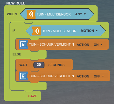

Ok, I have had some sucess with in this, but the device is just odd.
What I can do is have two rules like this, and then set the TIMEOUT_AFTER_NO_MOTION setting of the sensor to a value that I want. Then, everything works.a6e1172c934279418250196108d256af
However, I cannot merge these rules into one using an initial "Any" sensor value and then checking for motion.
The lights will then not go on. Odd behaviour.

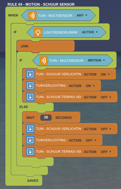

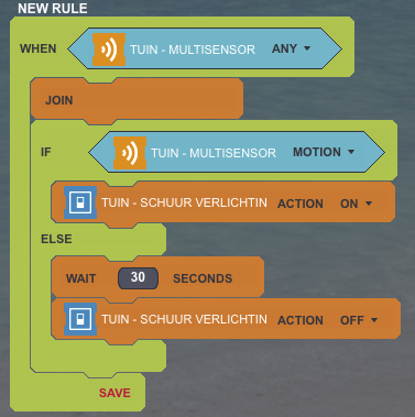

You could do like attached.
Within the IF you can also make an AND to for example use a sensor for light /dark so only when it's dark and there is motion the light will turn on.
Regards,
Slashroot
Ooops, Below the When there should be a JOIN :)
Hope this works for you
