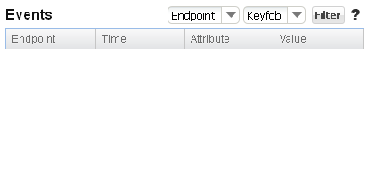

Another challenge for me now : make it works for scenes
It works for me with description Aeon Labs Key Fob v2.
After several tries keyfob is joined and visible.Could you tell us what is your magic fix without any software update ?

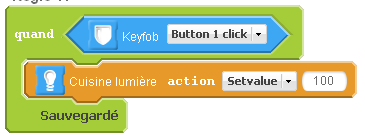

I've succeeded sending me a push notification with prowl using rules creator with "Control" item.
Thanks Milan.
I wish it will be easier to add it in version 1.0 ;)

(keyfob model DSA22, zipato firmware 0.9.971)
my process :
- add device, type : zwave.memkeyfob
- device found
I don't see anywhere the device in the dashboard.
In the rules creator, it's possible to create a rule with the keyfob, but nothing runs.
the list of events is hopelessly empty.
can you help me, please ?
thanks,
From 2 days, I try to use the KeyFob remote with zipato box, without success.
my process :
- device found
thanks,
