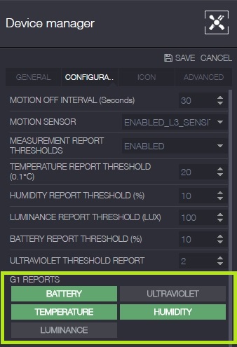

Did you enable the UV sensor? With me it was disabled by default so had to turn it on.
This is supposed to be where you enable the UV reports to be sent to the controller, but no matter what you do, it always go back to the showed settings, you can remove reports but I have never been able to set all 5 to ON and stayed ON.
Looks like there is an issue with the values that zipato is sending for UV reports, according to Aeon Labs values need to be set as follows;

Zipato is sending the following values, how I know? I used the G2 and send/retreive individual settings, and in UV I found the difference.
BATTERY-1
ULTRAVIOLET-16
TEMPERATURE-32
HUMIDITY-64
LIGHT-128
The fact that those are predefined values, you cannot change it, and you cannot add a custom parameter to set it because it is duplicated. I will open a ticket on zipato support.

On mine everything seems to work but UV reporting, perhaps is something related to what Ivan stated. Im using v 1.0.5
