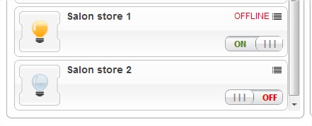

hi i have a problem with module motor controller of aeon.
i have only on/off ????
motor can on ly turn on one direction ???

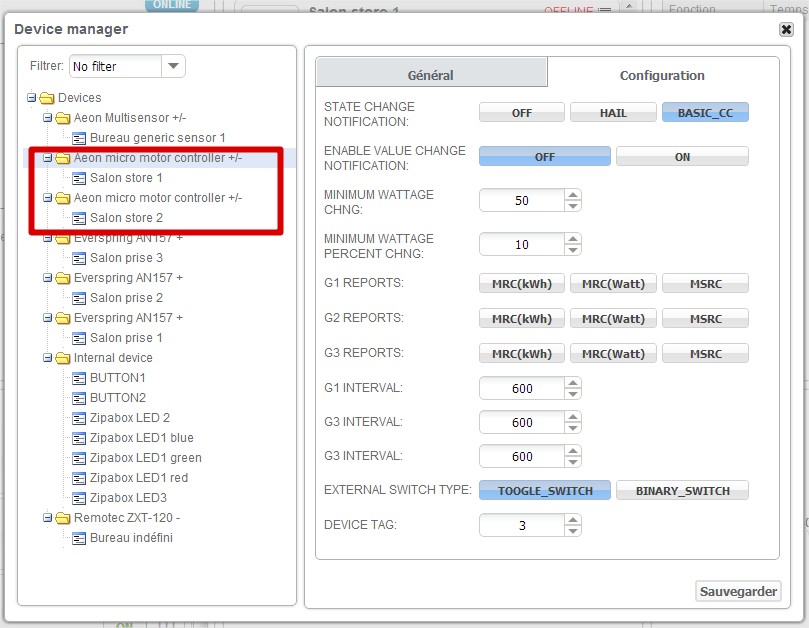

I just installed this module and works fine with switch and in zipato under Device Browser. But adding that in rules is not possible as far i tried. You can use the motor in only one direction. I cannot access this site from Lesly. Anyone has the solution?
You can use "set value to" (0 or 100) to activate the store to go up and down. In device manager add the level up "as a device" and you will be able to control it via mobile app.
