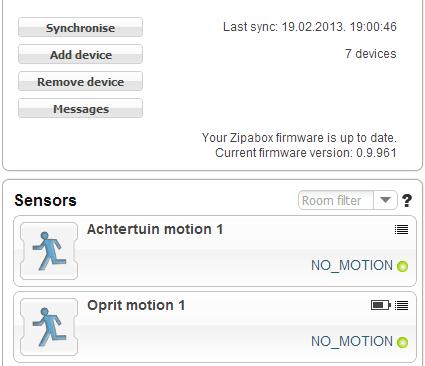

When a Aeon multisensor is offline or out of range, this is not visible in the dashboard.
Not in my dashboard.
latest firmware.
The only you see is the missing battery level. ('Achtertuin motion1').
latest firmware.
