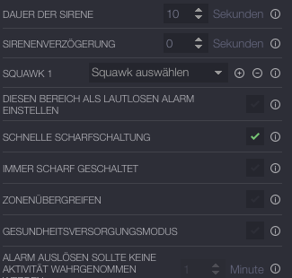

did you enable "Quick arm" in Settings?
regards Helle
Sure, see my last sentence.
But thank you for your help!
Andreas
Perhaps is the information for "Bypass" not correct transfered, because manually I can arm my system, but not by rules.
this is the option we talk about.
See att. Screen.
Regards Helle
I know. It is set

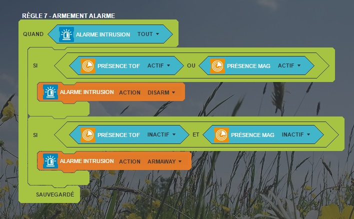

I have the same problem.My phone and my wife's phone have macrodroid with a macro to activate, each, a virtual sensor "absence" ... it works very well.I created a ruleWhen the two phone are away then arm alarmWhen one of the two phone is present then disarm alarm.
But it does not work.I have the "fast armed" checked though.
If anyone had the solution.thank you in advance
