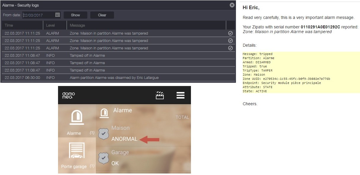

What device is configured on "MAISON"zone, the siren or the motion sensor?? whichever sensor you have configured on that partition is sending the tamper alerts, usually you have to install devices in certain way so you don't get false tamper alarms.
Both, but in my opinion the problem comes from the siren because before its installation no problem.
What do you mean by both? you can only have one sensor per zone, in the first image you attached, inside the alarm partition there is a Zone called "Maison" which is ANORMAL, that is the one creating the alarms.

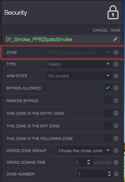

Do me a favor, from the web control app please go to your Alarm, expand your zones and go to "Maison" Zone by clicking on the small gear icon, then take a snapshot from its configuration as in the second image please. The sensor you configured in that zone is the one giving you troubles, as you mention, most likely is the siren, the alarm you have received is a TAMPER alert which is usually sent when the sensor has been removed from it's base, detached it's place or someone tried to destroy it. If the device is not properly installed it can give you tamper false alarms, please look at the manual I have attached and make sure the tamper key is pressed when placed on its base.

Something is weird on your Zone configuration, there is no sensor configured in Maison zone, set it up again, save and sync. What is the purpose of having the siren set up as a Zone? it would probably just be useful if you want to check for tamper on your siren, you don't need to add it as a zone in order to use it as a siren. Did you checked that the alarms stop if you unmount the siren and press the tamper key for 5 seconds or more?

Ok, so that zone is meant to be your motion sensor? I don't know how you were able to create it, in order to create a zone you have to configure one sensor to it, however I have experienced issues with some zones after upgrading firmwares, it appeared as "empty" zone and I had to re-configure it. If your sensor is not listed and you see it on the device browser only Zipato Support can help you to find out why you cannot select it on the virtual alarm, I would try to delete the zone and re-create it.
Regarding the last part of my message. You have mentioned that your tamper alerts started when you installed the Indoor Zipato Siren correct?, in the email you uploaded (automated email from zipato) I see that the zone "maison" is the one creating the tamper alerts, that is why I asked you for the screenshot, to see which sensor you had configured there, it seems that there is no sensor, so you have problems on the config of your alarm that need to be fixed.

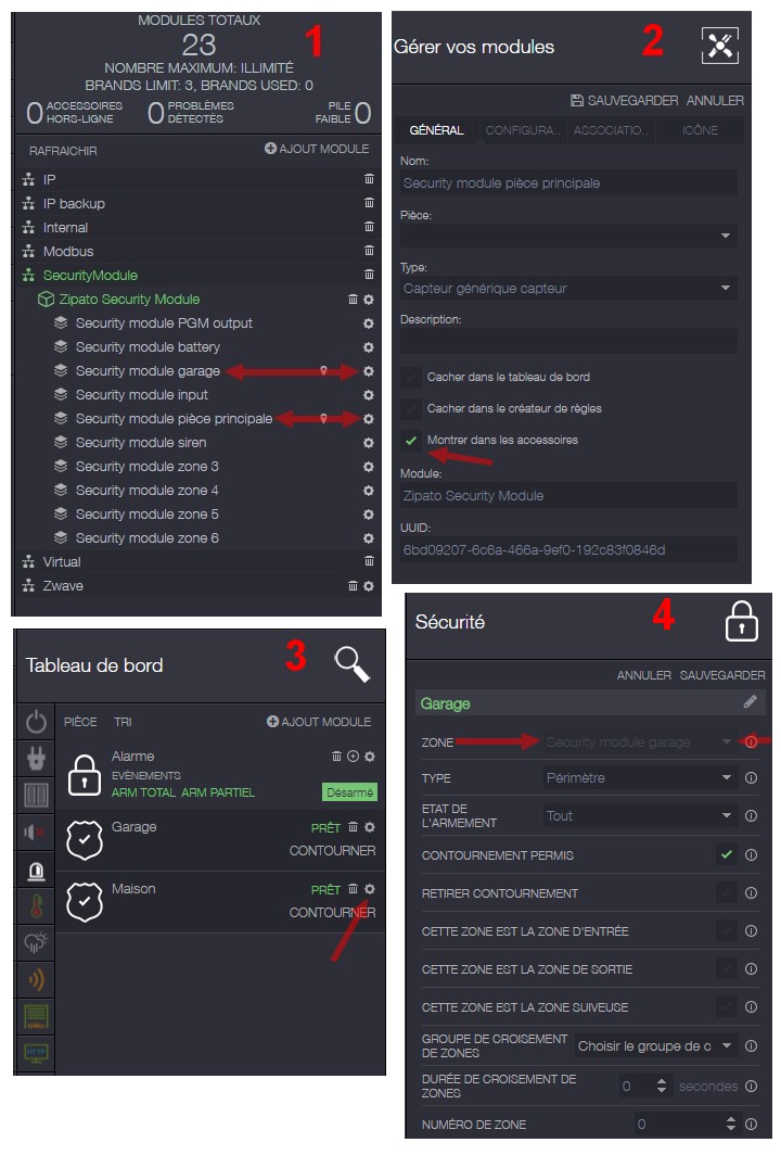

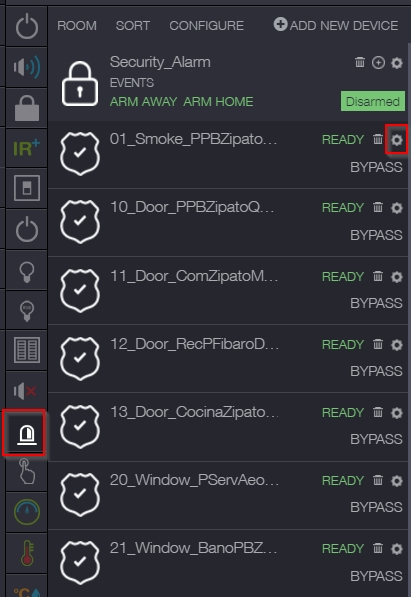

Hello Alberto;
I hope to have solved my problem thanks to your help.
On picture 1 I checked "Show in accessories"
In image 4 my motion detector now appears.
I did the same for the 2 zones.
