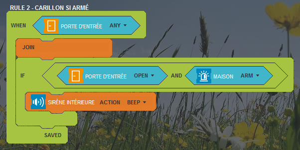

I created a rule to beep the internal alarm when I open the door and the alarm is set. So I know that the last person that left home did set the alarm. You can do whatever: turn on a light, etc ...
Dear Olivier,
Ive tried to mimic your Rule, but I seem to not have the siren action 'Beep'
I have ''Off' 'On' and 'Toggle'
Is the beep or the device a custom device?
Thank you in advance!
I use the Zipato Siren where you can trigger 6 sounds including 'door bell' and 'beep'.
