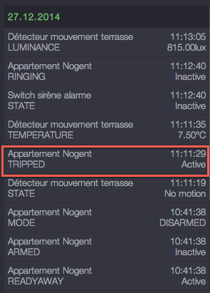

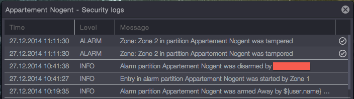

I came home today at 10:41 and I disarmed the security alarm (like everyday).
At 11:11, my siren started to flash and I received the following email:
Message: tripped
Partition: Appartement XXX
Armed: DISARMED
Tripped: true
TripType: TAMPER
Zone: Zone 2
Zone UUID: XXX
Endpoint: Détecteur mouvement terrasse
Attribute: STATE
State: MOTION
So the alarm was tripped while it is disarmed!!! How is it possible?
Usually it works pretty fine but today I am less than sure about how seriously Zipato handle the system.
In the email, the state says "motion" but in the logs we can see that it is not true.
I am also sure that it is not linked to the tamper because there was a lot of people yesterday making vibration around the Fibaro motion detector (FGMS-001) and the tamper alarm was never raised.
I would like to have clear explanation of Zipato about this subject else I am afraid I will have to find an other box more reliable.

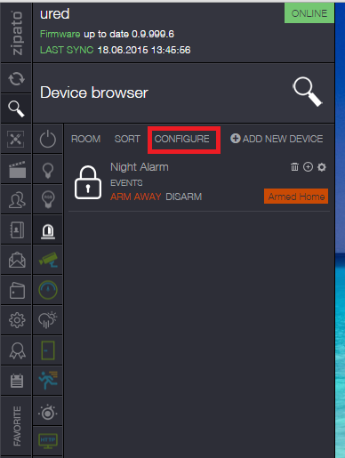

We will add this option in the new UI within a few days. However, activaTing this option will make your security a bit more vurnelable.

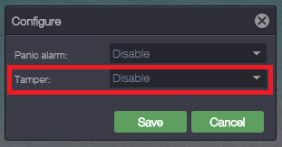

Hello Christian,
Do you have your Tamper setting = Disabled
Please take a look at pictures for more details
Hello Christian,

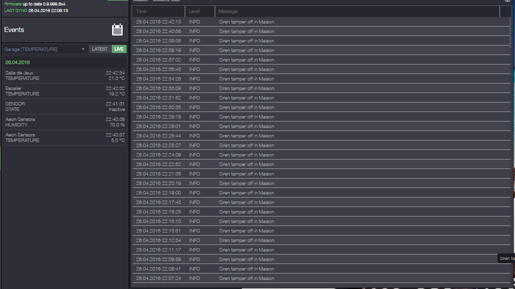

I don't understand how to diagnose and prevent those tamper messages. I even can't relate the security events with the sensor events. Please help !!!

Hi Pero,
No I have Tamper = Silent, as I don't want to take the chance of having the siren to randomly wake me up at night until I figure out the origin of these messages, as I am not tampering with any of my devices.... From my point of view, either the Zipabox is treating by mistake some other messages wrongly as tamper messages, or some devices are sending unsollicited tamper messages. This is why I was trying to relate the tampering messages with what was being reported in the list of events. Of course I could have my Tamper setting = Disabled, but I am reluctant to do that as it would defeat the purpose of being able to trigger the alarm in case of real tamper.
Hi Pero,
