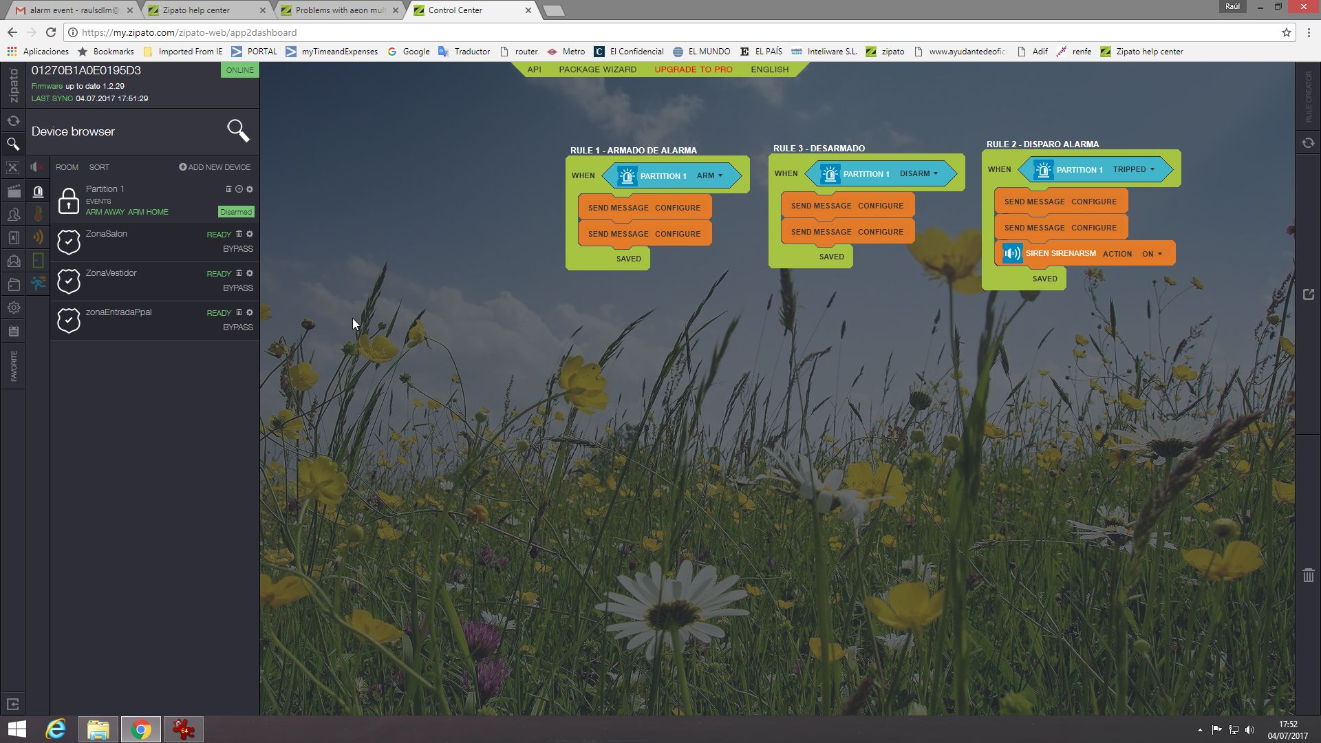

also another issue i had with these is the vibration or tamper alarm in the MS6 activating the alarm. I changed this in the alarm configuration tab to silent or disable alerts as their is no parameter to configure this on the MS6 itself
Hi Adrian, how did you disable tamper alerts for MS6? Misteriosly the alarm is activated by the MS6 tamper and I don´t know why... I cannot fint the way to do it in the zipato alarm configuration... Thanks!
it can not be done for an individual sensor only the whole partition (so every sensor). You go to the alarm panel in device browser and select "configure" then change the tamper to silent or disable.
