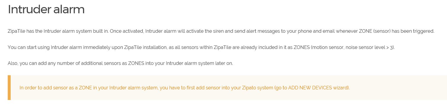

I have attached a snapshot from the "Help" (aka user manual), where it clearly states that this is possible...but I can't find where to create the zones...

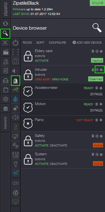

One of Zipato's YouTube videos states that there should be an icon to do this, right beside the alarm (or virtual alarm)...but the icon doesn't show in my web interface... (screenshot also attached)...

2. On the left side of the web UI go to device browser / virtual alarms (little beacon icon, see attached screenshot)/ intruder. You can expand this virtual alarm in order to see the configured zones by clicking on the little lock "icon" and typing the password (Default is 0000).

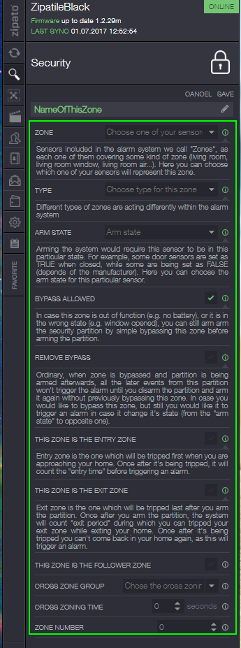

3. Click on the plus icon to add zones and configure them. Select your sensor from the popup selector, make sure you read what every setting is for, expand the help by clicking on the little "i" icon.
