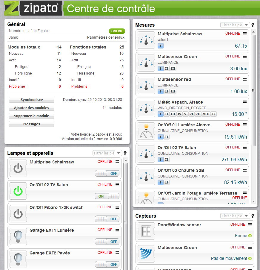

Dear Zipato Team,
It's now for 2 day's that I'm in Trouble with my ZipaBox.
All my Z-Wave modules are OFFLINE and not react if I try to manually switch them with the My.zipato web interface or with the Android App.
Sometimes some rules seems to start (Climate started yesterday afternoon ... but not stopped my Bathroom heater...)
This problems appears after I updated the Box with latest Firmware.
Now I try to press the reset button once, then I try to unplug power. Later I remove some rules and modification I did on the Box Web Interface. But Nothing change.
The Zipabox Blinked Green Yesterday when I come Hope, I did a power reset and now the Box have a fix Green LED.
Today I must directly press the manual switches on the modules to start and stop them (Hopefully Most of them are Power Plugs or similar)
Please Help Me to restart the good work of the unit.

Thanks to the Zipato support for helping me.
The Zipabox was defect and the only solution was to receive a replacement Box.
The
support and myself tested different manipulation (remove the units,
reset the Box to factory settings... ) But nothing helps... that's why
the support organised the replacement (THANKS DOMADOO in France).
Thanks for your help.
