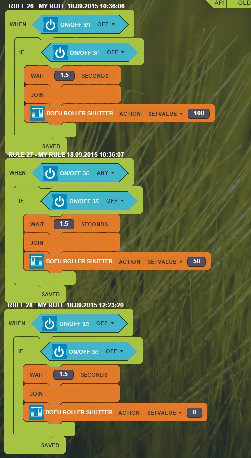

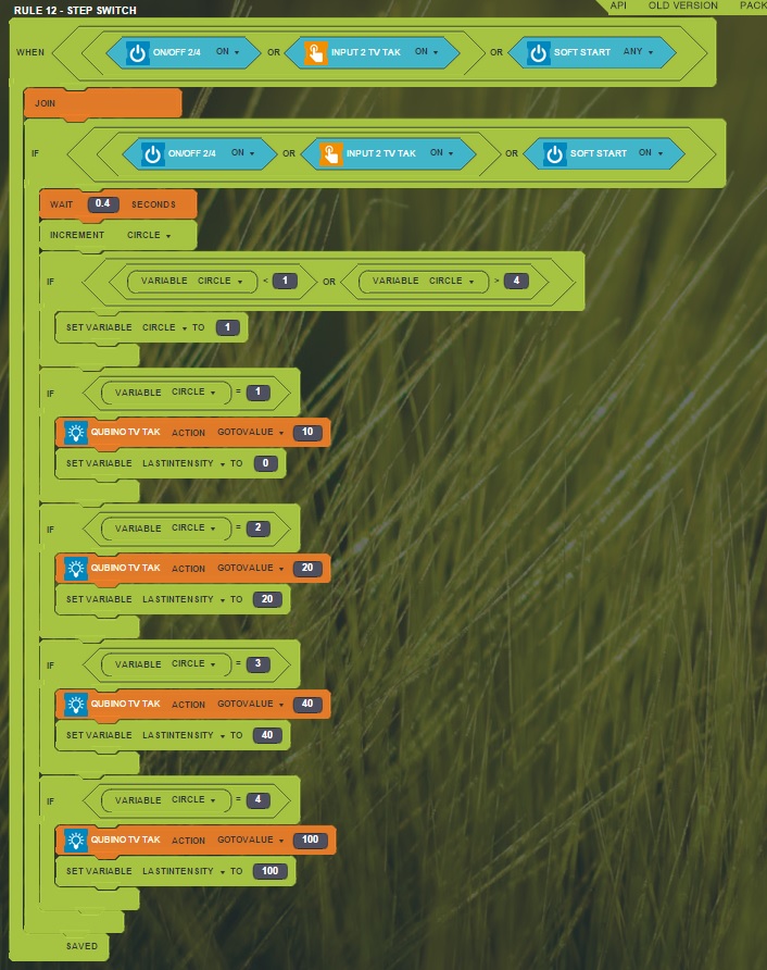

I also have problems with rule. My step switch rule have worked for month but now al of a suden it have stoped working. The variables does not seem to work, or the software switch or the hardware or the rule. But somethig does not work. Also my blinds test rules seam to work good some time and sometimes not.
The strange things is that most of the other rules work but some does not. And with the step switch I have not changed anything except that I use 9.9b beta software....
I have to use this beat to test my blinds.
