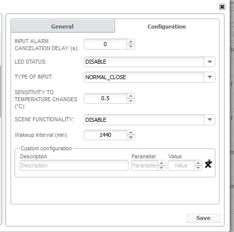

Find attached my setting for the Fibaro Door Sensor installed more than 6 months ago and still at 96% or 100% of energy.
