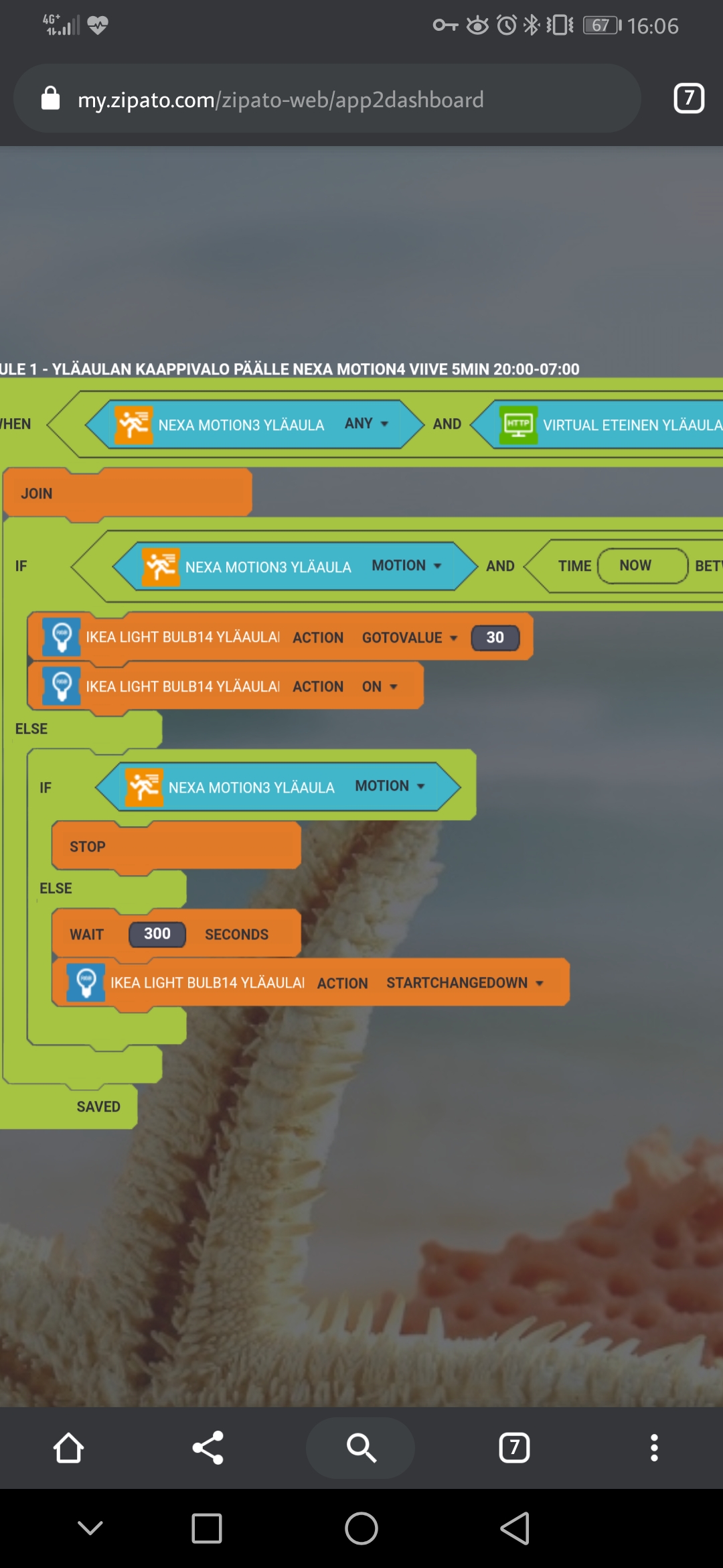

This type has worked fine for me(see attachment). I have paired motion sensor with virtual switch in rule so the rule can be turned of easily.

Thanks for your suggestions, I noticed that you all use the Join clausule,.. I tried to write this rule without the join as I could see that sometimes it has rare behaviours and don't stop previous running instances of the rule,..
Did any of you manage to get this rule without 'Join'? I guess it is a challenge,.. :-)
