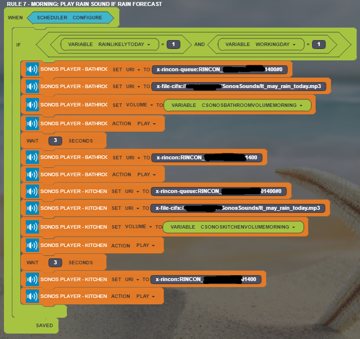

Yes, more work is needed. In the morning sometimes I play a sound warning about rain, and after the sound is played I want to return to whatever the volume was on each speaker - but I have no way to know.

As for pausing, playing a sound, and then resuming, I don't exactly do that, but I have a rule that interrupts the radio to play a rain notification. See attachment. I think it should be possible. I'm a bit hazy on the details of what I'm doing the rule, so I'll have to check when I get home. Queuing should be involved somewhere, I think...
What the rule does is first set the URI of the speaker where you want to play the alert to:
x-rincon-queue:RINCON_<MACADDRESSOFSPEAKER>01400#0
and then sets the URI to the MP3. I'm not sure why I do the first step. There must have been a reason for it, I can't remember.

But here's something that I'm pretty sure *would* work. Suppose you have a Connect + 3 Play:1s like me. You group them and play Spotify or whatever. Then to, play your alert, you pause, ungroup, choose one of the units to "save" your position in Spotify - let's say the Connect, set the URI of the MP3 in one of the Play:1s, group the rest of the Play:1s together with the Play:1 with the MP3 URI, play the MP3, ungroup, regroup with the Connect, Play.
Yes, it will be a long rule :-). But it should work. If you only have speakers, and no Connect, you'll need to choose one speaker that doesn't play the alert.
