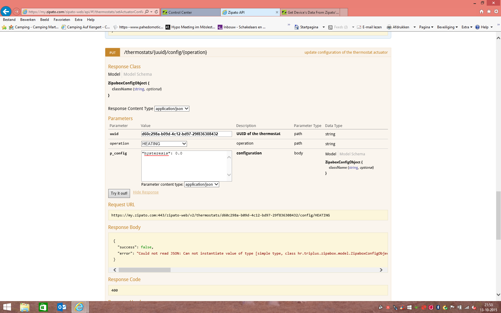

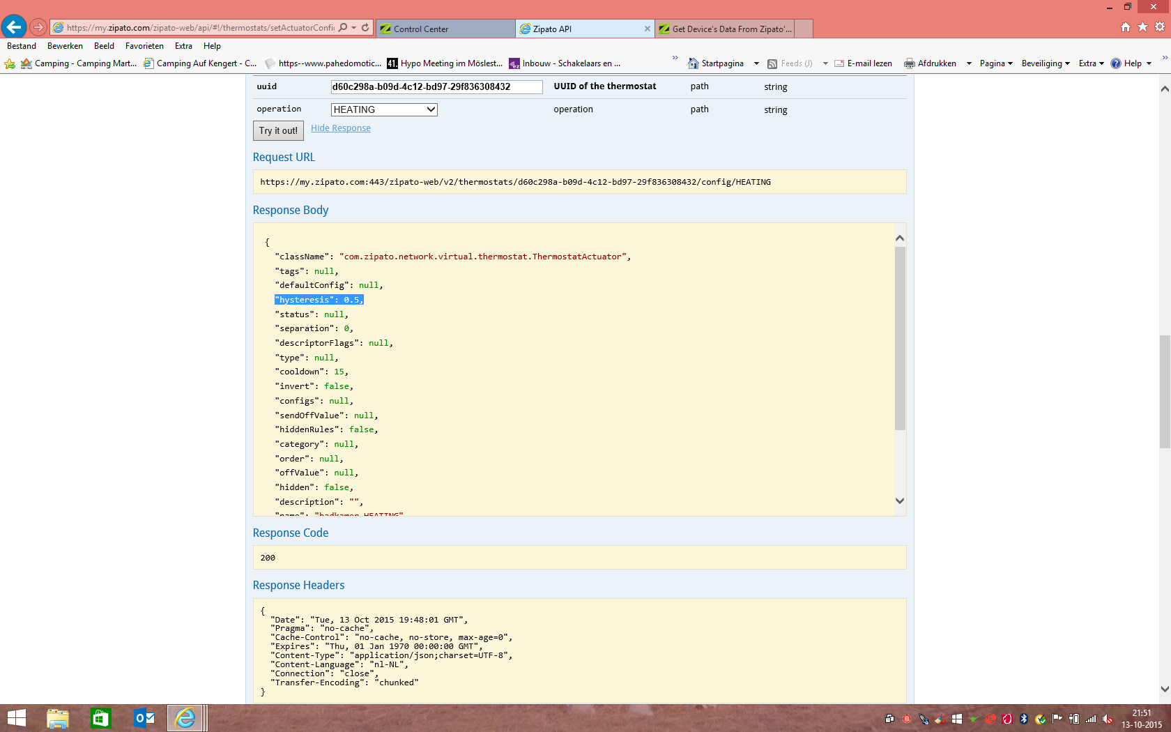

You should copy the entire output of the JSON in the GET (the hys.png) and paste it onto the p_config box. Ajust the hysteresis parameter to your desired value. I set mine to 0.2 degrees, and it worked fine. I'm not sure about 0.0 though, but you could try it ;)
Hmm, when I PUT the new values, I get a HTTP 200 and the output indicates that hysteresis have changed value. This is great. But when I check with the GET (configuration), the 0.5 hysteresis is still there. Not so great!

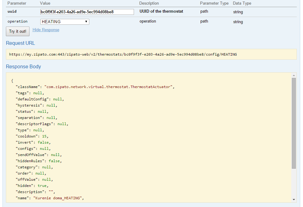

This is strange. I have hysteresis as null. Try it with value null. I'm not sure if this is good or bad...

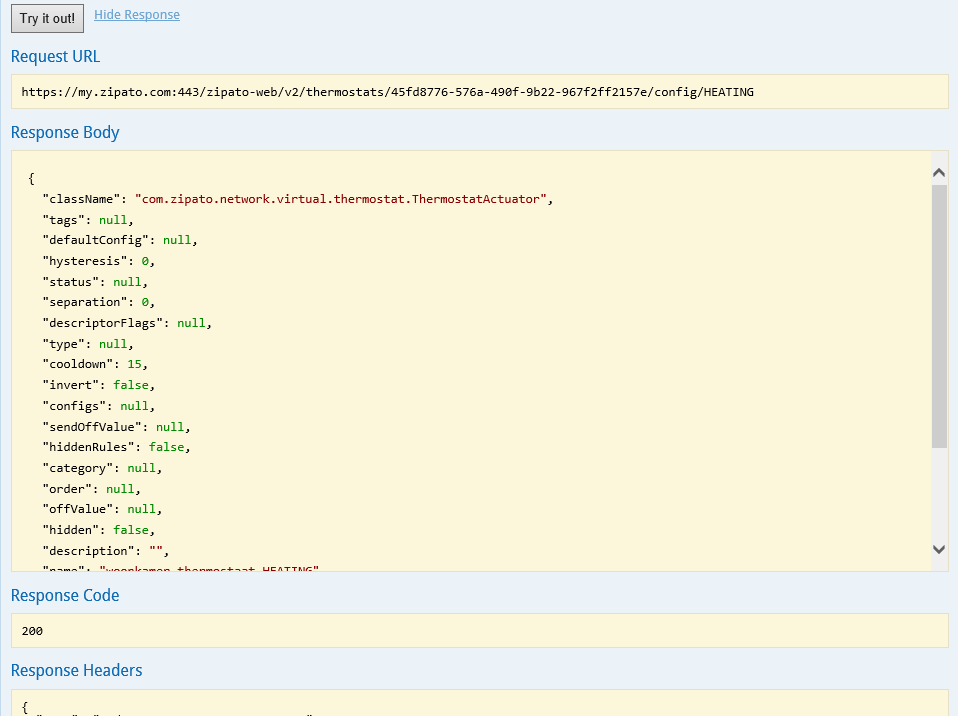

I think I changed the setting to 0 in the API . Let see if it works over the next days

Yes! it actually seems to work. Yesterday, when I checked the value after setting it with the API PUT, it was back to 0.5 Today it shows 0.2! There must have been some server side cache/lag issue, as yesterday I checked with a different browsers as well, to be certain that it was no browser cache issue.

So what does it mean for me_ I dont have hysteresis? Is it same as 0?
Attila, I don't know what it means for you. I am currently monitoring my setup to see if rhe thermostat actually uses the hysteresis parameter at all. If it does, you can change it with the API functions (see the screen shots provided by Marius D.)
So what does it mean for me? I dont have hysteresis (it says null)? Is it same as 0?
