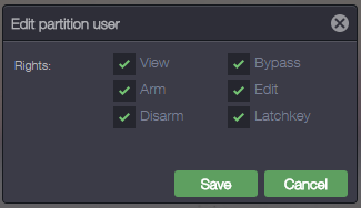

Can you check which options are enabled when you open Security partition settings - USERS tab - click on the name of the additional user.
If I click on username in "Users" tab, it happens nothing.
5a43f985725fe3de76a23f9103a67fa3
Hey ! I didn't know we can do that !
And it is solving my issue !
Thanks a lot for your help Antonio !
