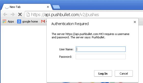

I need to pass user\password parameters in the same way i'd do in a browser tab (see attachment)

Hello again Paolo,
in your URL after // type your user name and password:
//username:password@api.pushbullet.com/v2/pushes

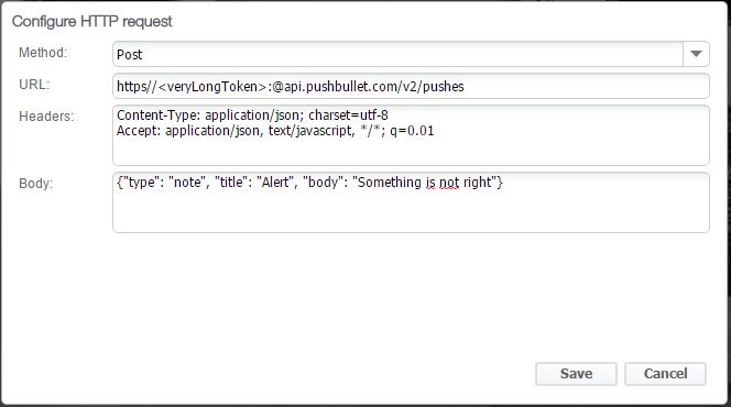

Unfortunately my HTTP request is not working yet, because I'm having trouble with json body (see attach). I saw there's a post regarding json but no helpful answer.

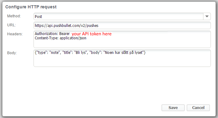

If your goal is to use pushbullet for notification you'll need to specify the bearer token in this way (see attachment)
Thank you, Pål, my goal was exactly that! But meanwhile, as I didn't find any solution, I switched to Pushover. I think I'll try anyway...
