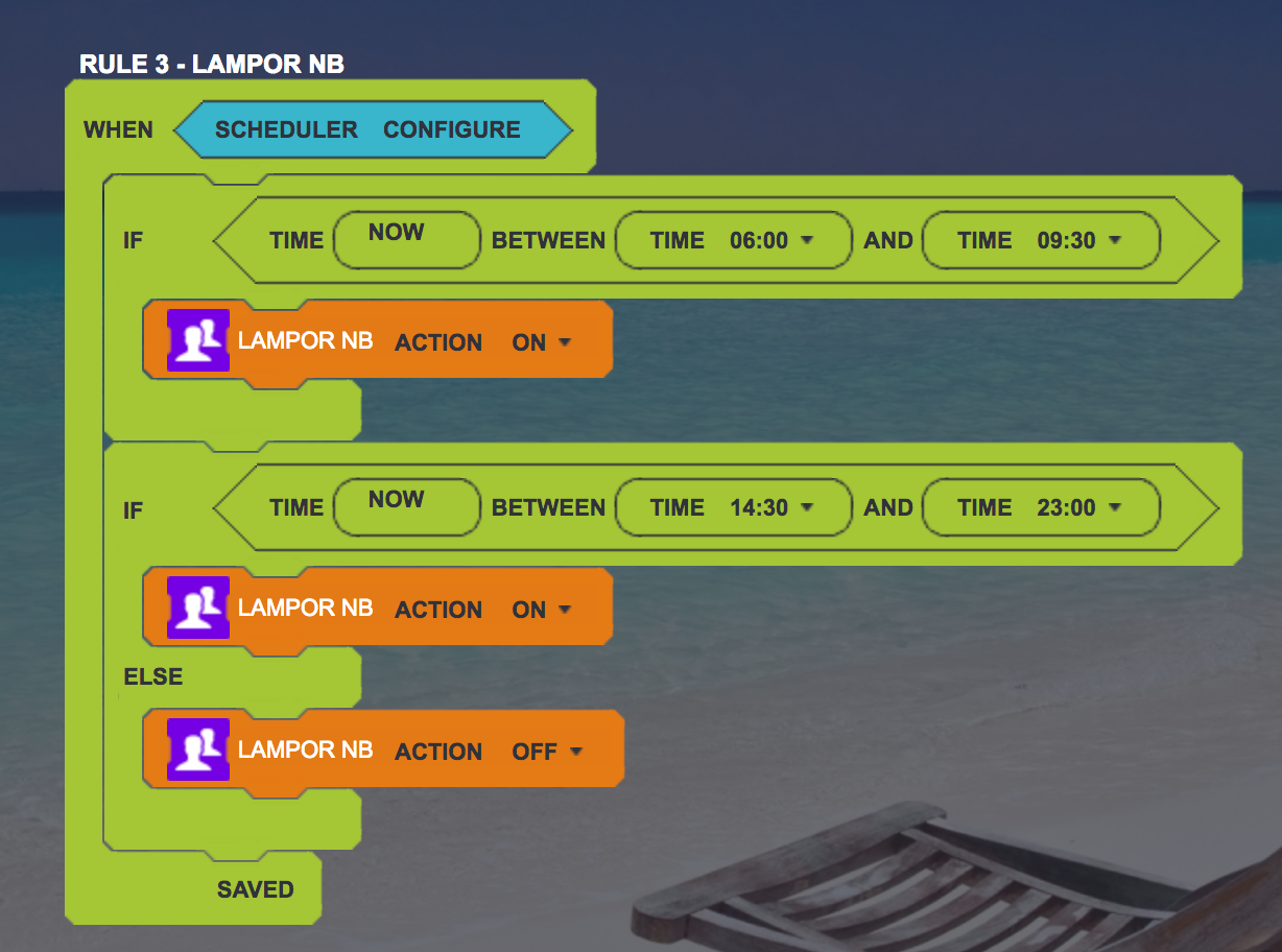

Do we still need four different rules or can one use the IF and IF/ELSE blocks?

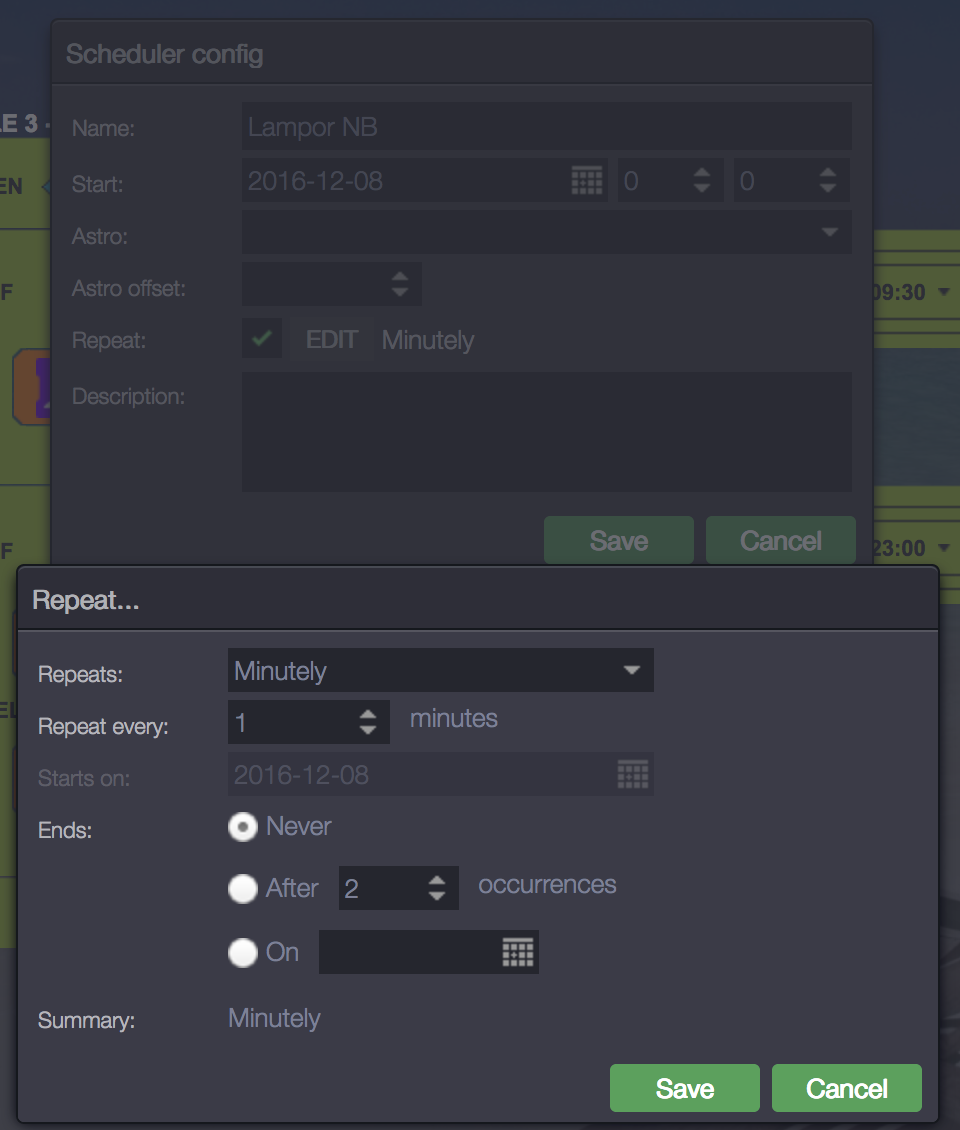

I attached a image of a script that do turn on the light every minute but turn them off just as quickly again.
I'm new to the Zipato scripts so any pointers would be great.

I might have a solution to my own question.
Using the OR block the lights are on in the first timeframe.
Let see if they turn off and then on again at 2:30 pm :-)

PS the Scheduler is the same.
