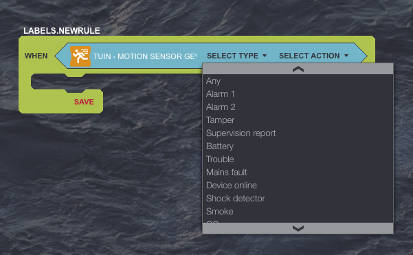

Hi EddyZwave,
I did not test it but it might be possible to use Puzzle - Advanced -Alarm component
This gives you various options like tamper, battery etc
I attached a screenshot where i added a motion sensor.
Hi EddyZwave,
