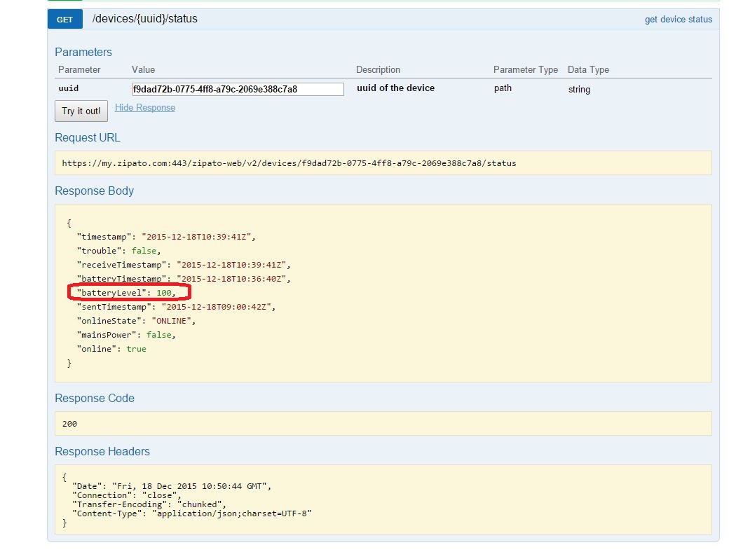

Is there a way to get device battery status using the API ?
Dear Mauro,.
Yes, it is possible. Please check attachment.

Dear Mauro,.
