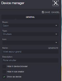

The old UI and the New one had this button (up/down and no stop, and on/off in the rules)).
The new shutter device has not the same options (time up/down)

Change cero to the seconds it take for it to go upp and down! Otherwise it will not move, because the box think it takes 0 seconds for it to go down!
Sorry, but I can't save anything, see above picture invalid.jpg. I will try an old firmware to fix it.
