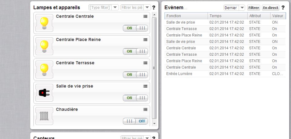

In the step 1, I switch all the lights on using the wall switch (I have tested using associations or by defining rules and I have the same behavior)

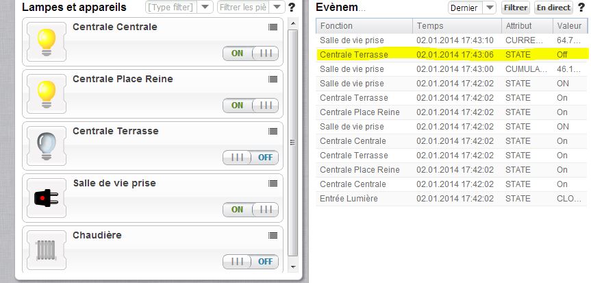

In the step 2, I used the dashboard to switch off one single bulb ("Centrale Terrasse")

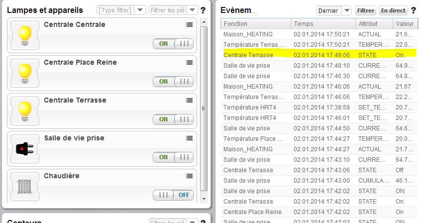

In the step 3, this bulb is automatically switched back on without any request from me. It seems to occur always 5mn later.
