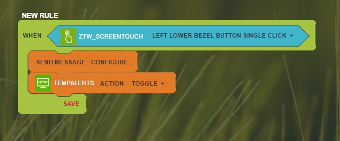

Stephan,
Try something like this. Zipatile buttons are found on Control devices and you can put any action you desire within the When condition.
Regards.
Stephan,
Regards.

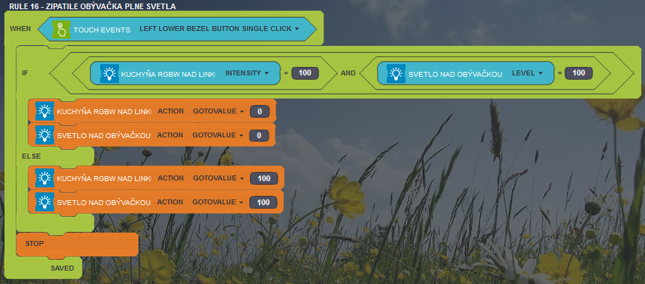

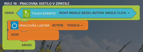

See my two rules. The light switch is similar to Alberto§s. The dimmer rule is a bit more complicated, but what it does is tho basically toggle the two light. If the two lights are not synchronized, it synchronizes the two lights and then simply toggles.
