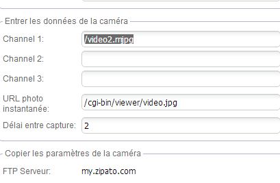

I have a DLINK DCS-5220 camera connected to the site Zipabox. It sends pictures on nouvement detection. The Ftp transfer is ok.I can see the live Strean with Vcl media player by rtsp :/ /192.168.1.21/live.sdp.How can i set the zipabox to see live stream.Thank you
Replies (3)

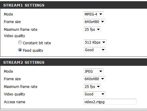

i've found a solution
Dont'use mpeg-4 mode but Jpeg Mode ( Stream 2 for me )
See the attached file for configuration DLINK and Camera on Zipabox
