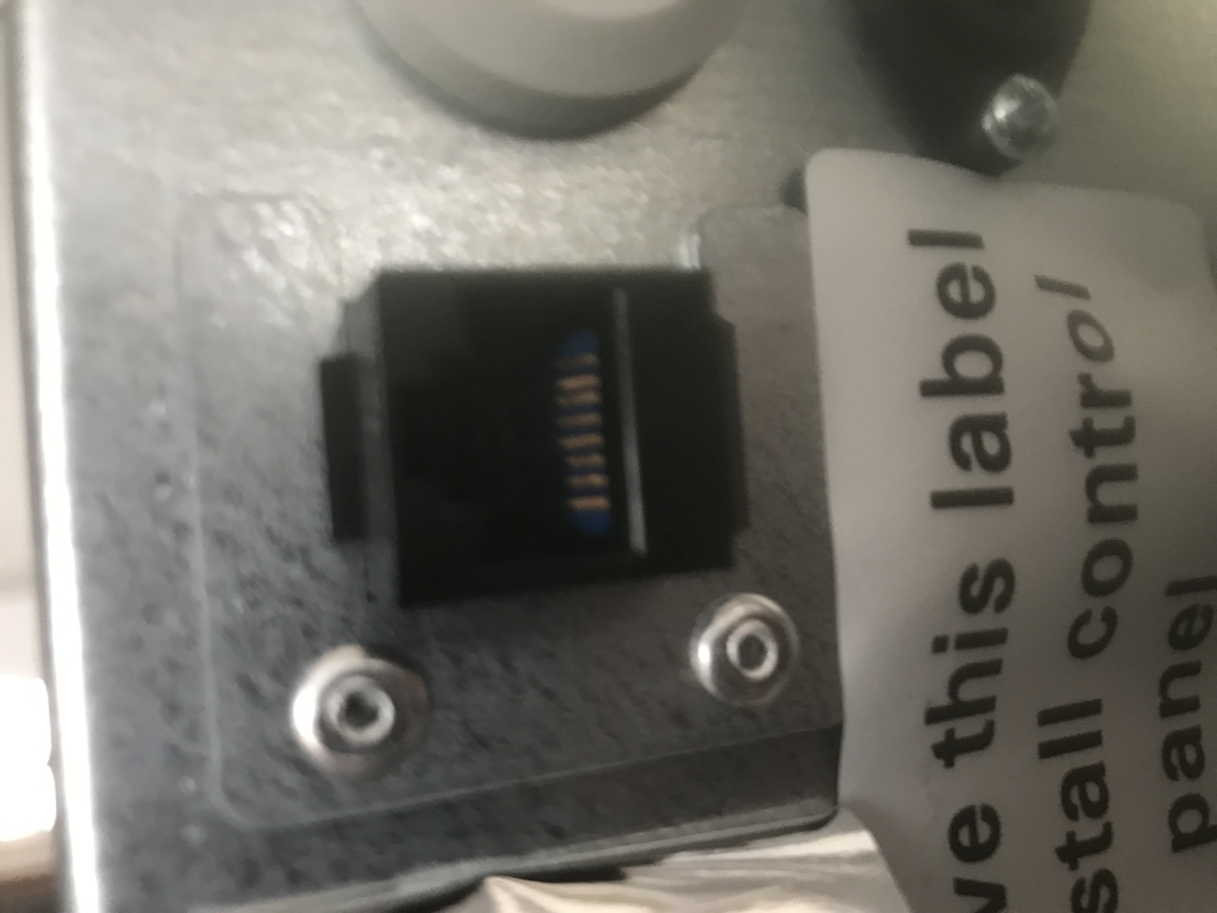

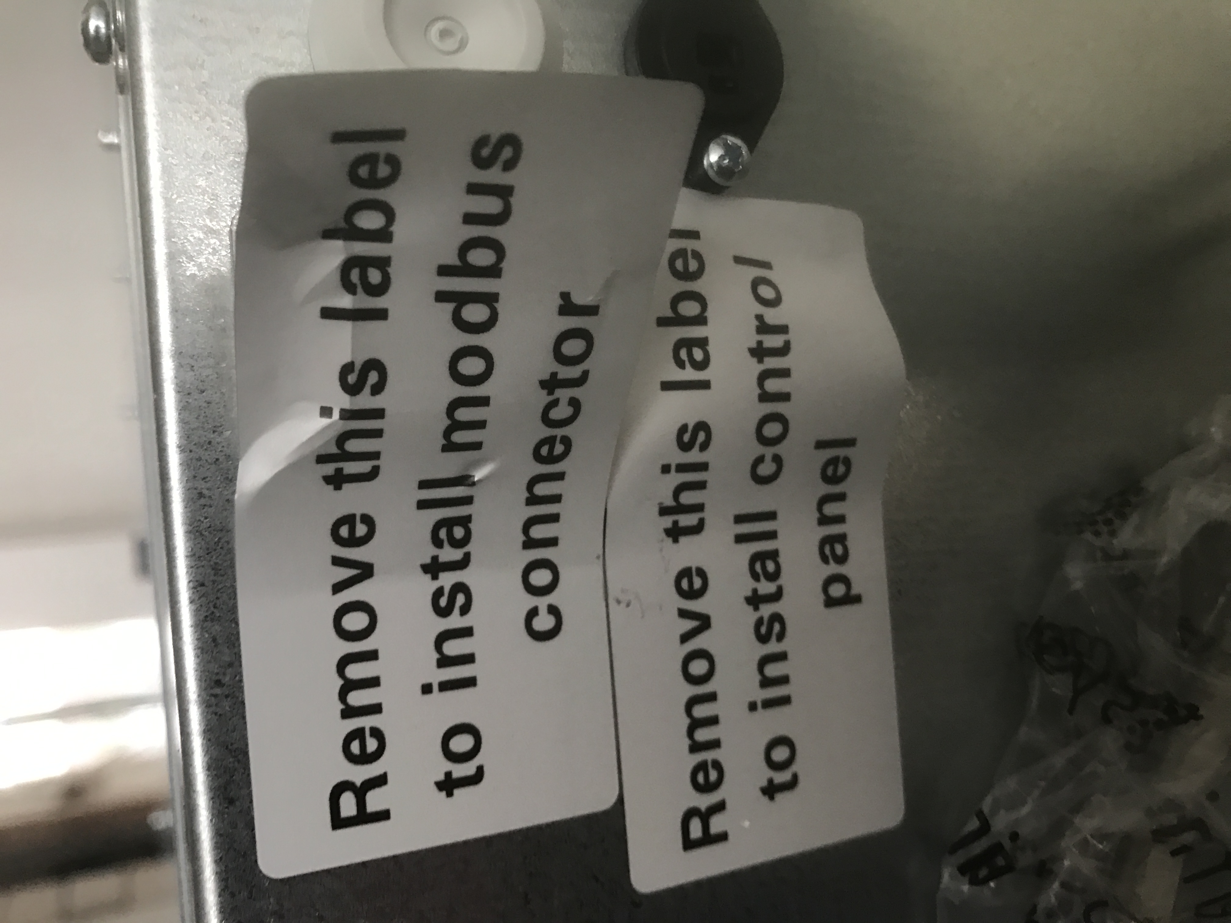

Ok i see on my reccuperation unit these slots:
Please check the recuperation documentation, you will find here each slots and their combination meanings
