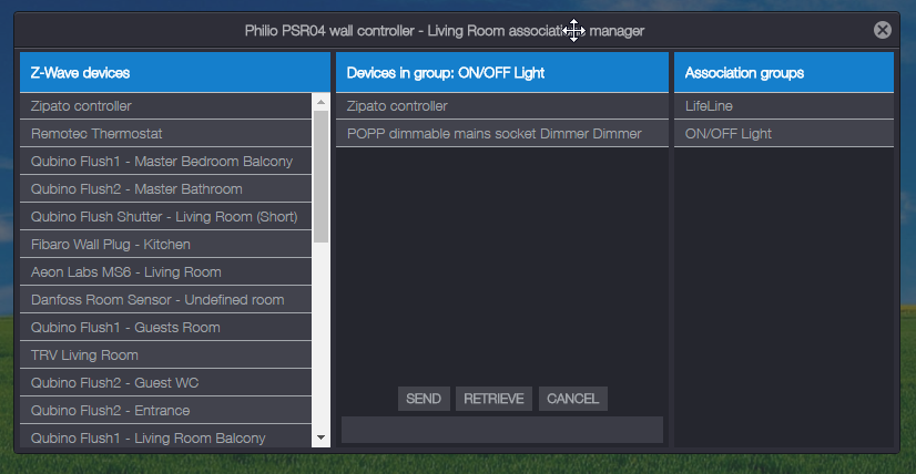

why not, simply choose the "on/off Light" from association groups and drag the z-wave device to it.

It should work a lot better now, try to rejoin your units. Please note that you will have to associate your controller with association group 2 of the device. Dimming function will not work without this.
Greetings,
Absolutely perfect. It works every way it should. Only thing I can't see is the on off comand. It always show false and no history. It is showing a touch control.
Also the group 2 in association does not say Group it is saying ON/OFF.
But this info about group 2 should be in the compatability list you should publish.
