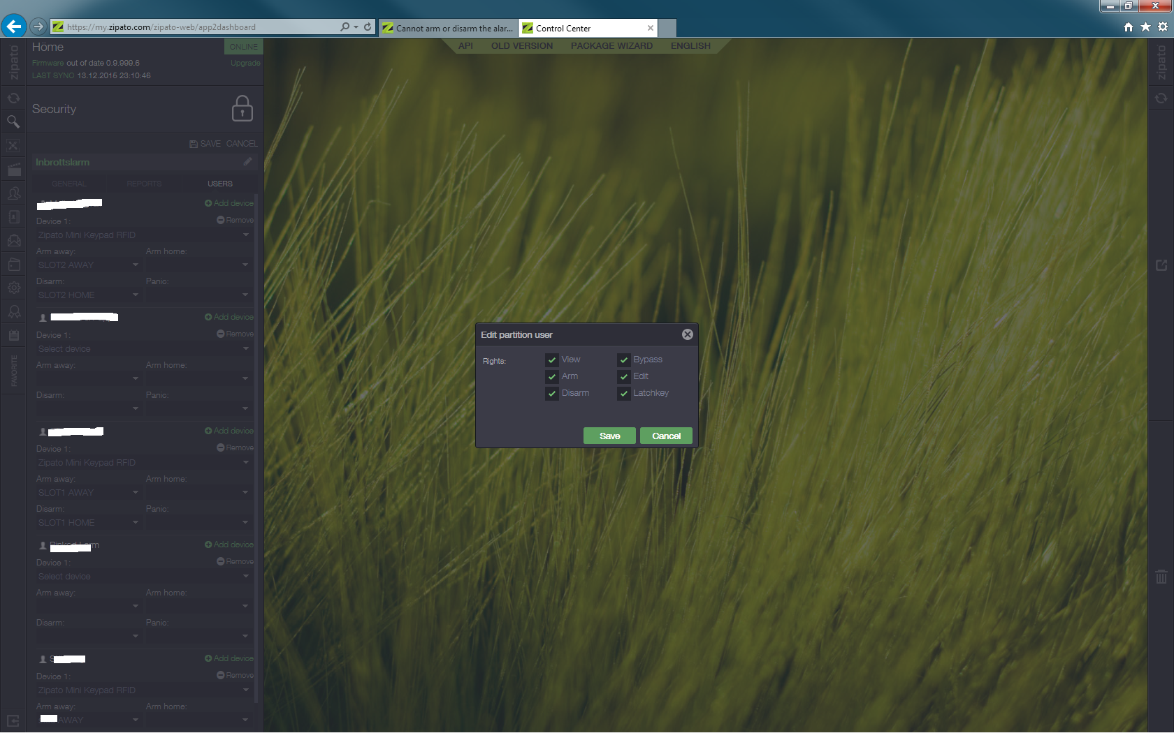

And last but not least, you have to also give every user the right in the alarm pertition. So you go to the alarm part, and user tag, click on the username, and you will get this menu, give every user the rights.

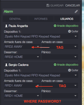

Thank you, I have another question: I attach image about my users setup, I did setup for my tags, and as well as I setup the tags, how can I setup passwords that I already assigned to keypad?
