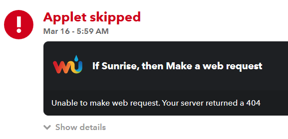

I notices having problem in ifttt:
Same here. Always 404. Weather not working and also ifttt work around not working.
Basically sunrise/sunset functionality totally broken...
