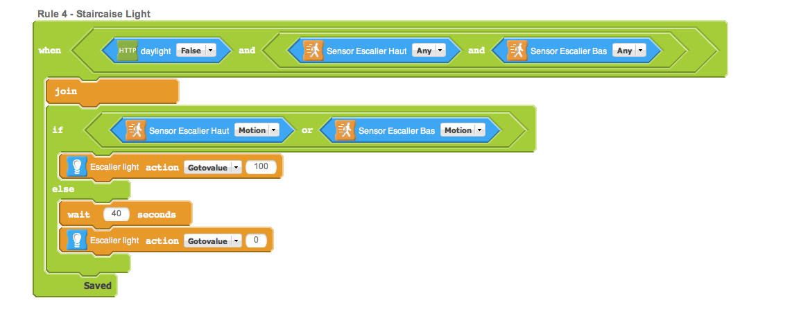

Hi, I am trying to control a light from 2 motion sensory ( top and bottom of my staircase) but what ever i do it works well for one of them and on the second it just doesn't take into acocunt my virtual sensor ( light comes on even during the day).What am I doing wrong ?

HeroS is right.
Your current rule will never trigger because you will never get two events at the same time (sensor AND sensor).

Well I just tried this and even though daylight is true. The light goes on when "Sensor Escalier Bas" is triggered.

Not sure if this will help, the problem is it works were it should not be. During the day when the virtual sensor is true nothing should happen. this is fine when one of the sensor but it wrongly trigger with the other one.

Everything is ok with the rule, you should test it in the way HeroS suggested (you would see that it never passed the first if condition).
Your sensor "Sensor Escalier Bas" is binded with "Escalier light" and because of that your light is turning on/off. Just remove binding (don't forget to sync) and everything should work fine.

Nenad is right I found the wrong binding and corrected it.
