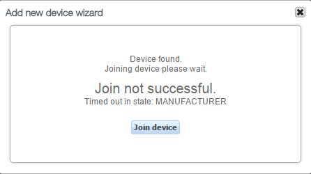

I just bought the RFID keypad and cant get it to join. Is this a common error?
When I hold down the tamper button (not a switch on my device) for one or two seconds I hear and see the device blinking couple of times like it trying to send me some morse-code.
I have done this many times now and sometimes I get it through the first detecting step, but the second join step it always fails on diffrent errors "Time out in state: Manufacturer/grouping/add device etc)
