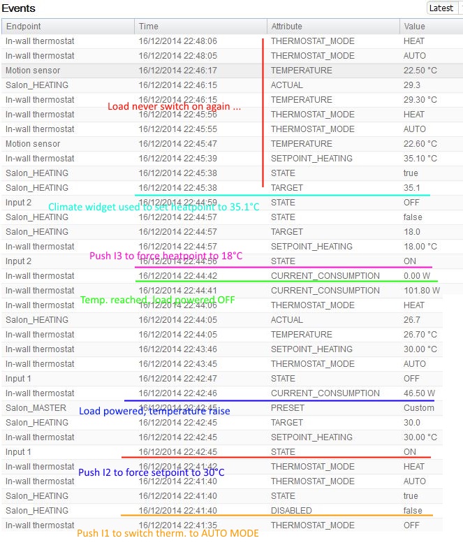

Can't use Qubino thermostat with climate widget
ZMNHIA2 device (Qubino thermostat) works correctly when used in standalone mode (setting heatpoint with integrated inputs).When using climate widget, Zipabox seems unable to set heatpoint temperature in device. What's going wrong ?
Attached is log file related to my problem
