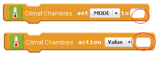

I have found this two actions:
for the first one it should be possible to ad a mode (heating, off, absence...) but I do not know ho to set the variable.
The second one is possible to write a value (8°C). I'm not sure how it works.
Please help.
Please help.

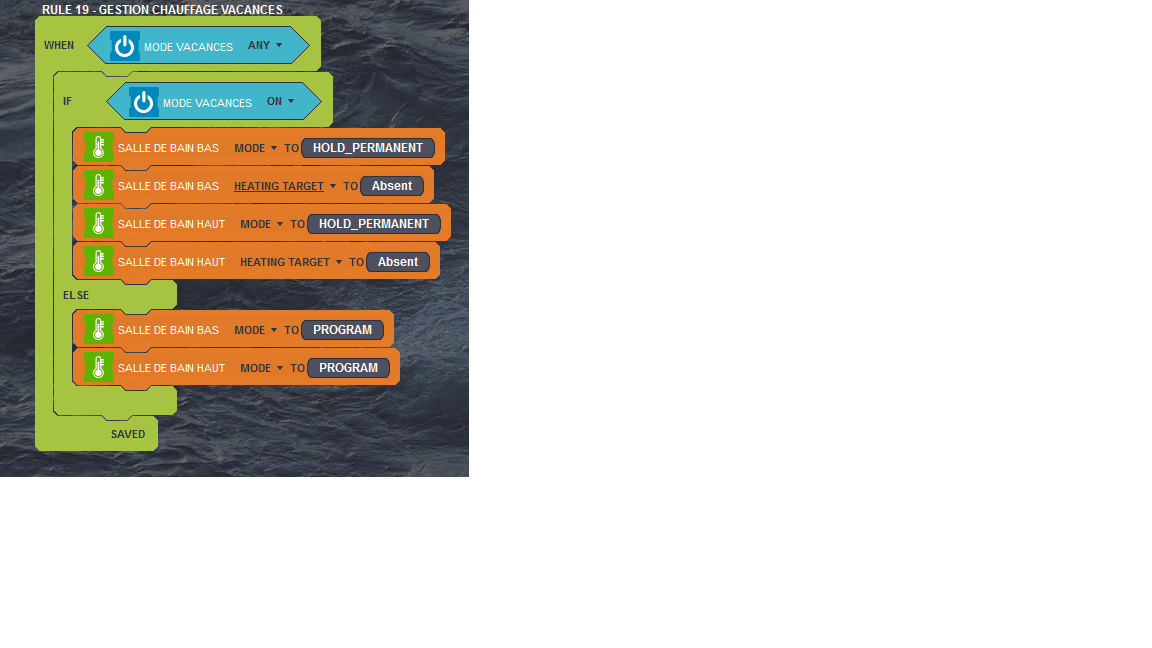

here is my rule for holidays.
On virtual switch (vacances) and 2 thermostats.
op this can help you.
https://community.zipato.com/topic/modes-buttons_1
