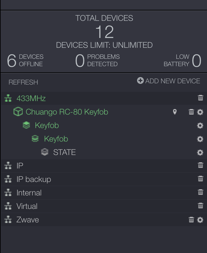

I am trying to include my old Chuango alarm units.
The key fob get included without any trouble but afterwards I cannot do anything to specify the four keys.
How do I use it in my alarm setup?
Cheers
Thomas
Replies (3)
You have to built rules
I know - but I do not see the buttons or anything to use for registering input.
See attached picture.

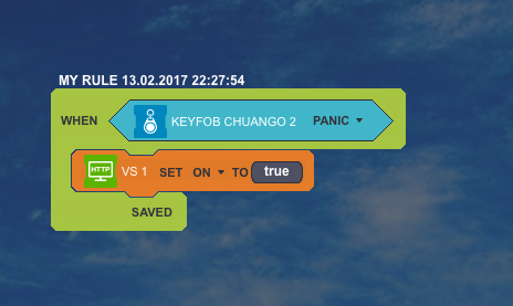

I have the same problem. No buttons show in Device Manager but they do appear in Rule Creator when you select the key fob. However, they do not seem to work when used in rules. Nothing happens. The rule works fine when I use a Chuango door sensor to trigger it. Anyone had any luck???
Send a screenshot of the rule. The remote controller does not usually have a widget as it is an input device. It should be used in rules and in alarm widget as input device for a user to arm/disarm system.
I have an update. I can a get rule to respond if I set the sensor key fob button to "Any". Selecting an individual button like Panic or Disarm results in no response. Also even when "Any" is set the response is quite slow.
