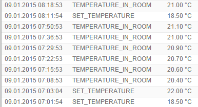

Climat "Until next period" doesn"t respect the Next period when changing manually temperature via HORSTMANN HRT4
Everything works fine with the program.
The program starts to heat at 9 am (SET_TEMPERATURE=22°)
Before 9am, SET_TEMPERATURE is set to 18.5°
When I manually change the temperature with the HORSTMANN HRT4 at 7am to 22°, it's working. BUT, after a while, the SET_TEMPERATURE is back to 18.5 (see events screen capture)
So, why the zipabox changes the temperature BEFORE "Next period" ?
The "Until Next period" doesn't work with the web widget too. I always have to use "Hold for"!

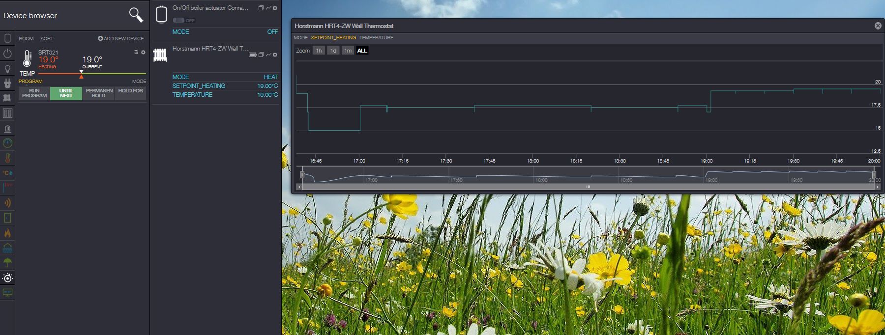

Zipato firmware up o date: 0.9.999.8k
Horstmann SRT321 + Boiler Actuator
SRT321 Wakeup intervall: 10 mn
Program in climate: 00h00-17h00: t°= 16.3
17h00-19h00: t°= 17.2
19h00-24h00: t°= 18.8
I add the following problems:
1- when program is running, it switch to "until next period" at SRT321's wakeup time.And setpoint_heating t° increase to the next entire value.
For exp: 18.6°program => 19.0°when switching to next period.But t° in SRT321 chart shown 19.3°; then 19.5°.
2- when I change setpoint_heating t° on SRT321, setpoint_heating t° changes in "climate".
when I change setpoint_heating t° in "climate", setpoint_heating t° doesn't change on SRT 321.
