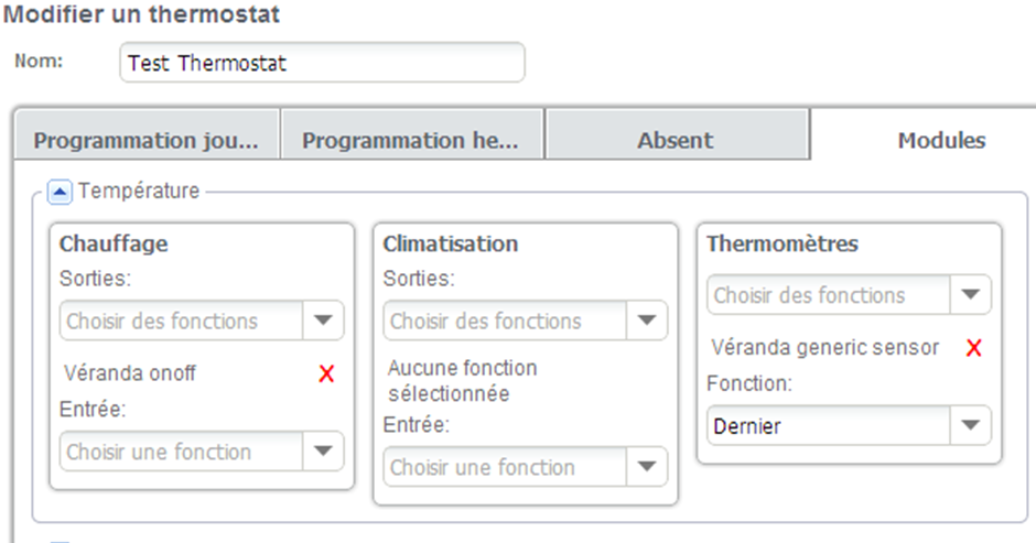

I setup a thermostat, based on a ST814 thermometer and that should switch on/off a AN157 plug

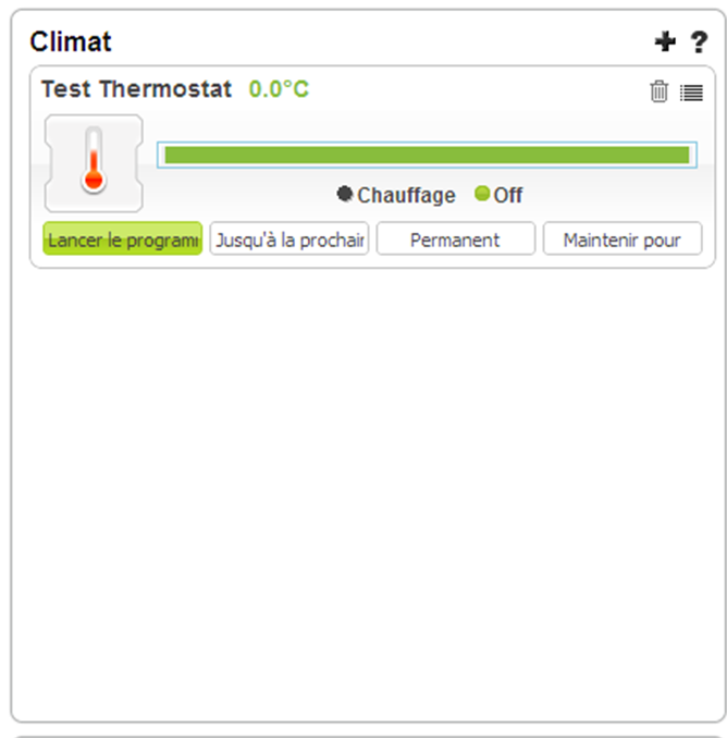

The problem is that in the dasbboard, when I click on the 'heating' button, a few seconds later, is goes back to 'off' (cf screen shot)
2nd problem: I do not see the current temperature in the thermostat: it is always displaying 0,0°C, wherease I think I put the right parameters in the 'devices' section (cf screen shot)
This is a sync problem, it will be fixed in new firmware today or tomorrow. For now, just restart the Zipabox and it should work.
Regarding the 0,0°C temperature, once after you create/save the thermostat configuration, you need to wait until thermostat gets the temperature from the temp meter for the first time.
Thank you for your prompt answer.OK for the 1rst point.
For the second, actually the thermostat was created 2 days ago, the temp meter was also installed 2 days ago, so I think 2 days should be enough for the thermostat to get the latest temperature !
Let's wait the new firmware and we will see if that solves both problems.
I confirm this works properly after a reboot of the Zipabox: thermostat stays on 'heating' and the current temperature of the room is correctly displayed
