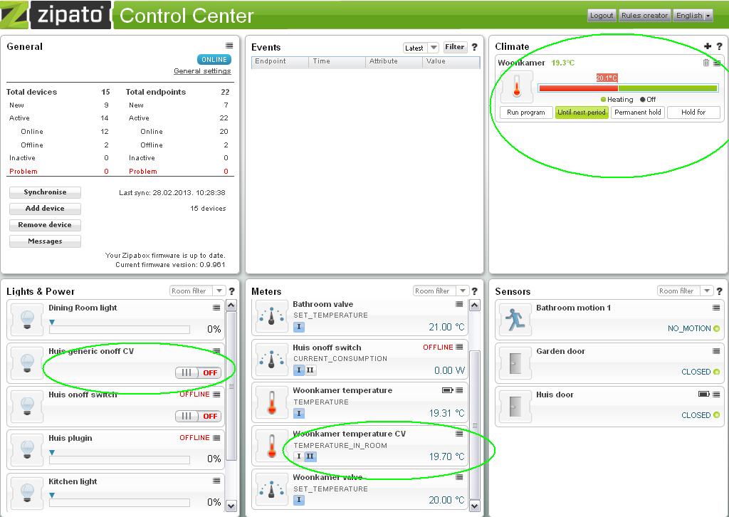

I am transferering my zwave network from a Vera3 and I have an issue with the climate control.
I have a Horstmann HRT4 including the ASR and have my climate widget setup as follows:
Output: Horstmann ASR, Input: Horstmann HRT4 and Temperature also the HRT4 (setting last).
Since bothe the HRT4 and the ASR have been connected I can follow the statusses of both but this isnt working for some reason.
The setpoint of the HRT4 is 17 deg (since I want the Ziapbox to control it) and the Zipabox setpoint is 20 deg.
Its now 19 deg and the ASR does not get a setpoint to turn on.
Also, the widget shows 19.3 deg as a read temp while the HRT4 shows 19.7.
I have them associated in case power fails.
I really dont get whats going wrong. Yeasterday during testing, the widget suddenly had a setpoint of 25 degrees.. and whatever I tried, the ASR was not turning off (untill I did this manually).
Could please someone help me with this?
2 other questions while Im at it: does the HRT4 show the setpoint of the widget or is it to overrule the widget only (and what happens at the next period? does it reset?)
Also, can anyone tell me how to set the danfoss valves to a temp manually? I cant find a input of adjustment field anywhere...
Thanks!!
ps: when I change the setpoint on my HRT4, the setpoint in the widget also does not move everytime (it worked about once I think..)

Still not working correctly... at all...
The heating is turning on on a different time than on the schedule and is not switching off. Today it went up to 21.8 and I forced it off by manually switching the heaterswitch off (it had a set point of 20.5 deg.).
It turns on in the morning but does not stop nor regulate. I understands that there is a hysteresis and therefor the temp overshoots but the heating stays on for hours and drives the temp up to 2 deg above the setpoint and that is the point that I switch is off (otherwise it keeps going up)
Also, temperatures are not displayed on the HRT4 when the widget sets a temp and the widget does not set the setpoint of my danfoss valve.
The thing which is solved is the setting of the temperature by the HRT4. I can see directly on the widget that the HRT4 sets the temp.
Please help, this is not working as it should at all...
since 2 days, the temperature of the HRT4 is not correct anymore.
It shows correctly on the display of the unit but the zipato interface shows 18.4 amnd turns the heat on without switching it off (which I have to do manually unles the widget receives a setpoint lower than this of course...)
Still, the working is not correct to say the least...
I really need help on this, Im burning gas as an idiot at the moment and I manually need to set the heatingunit on and off by controlling the switch itself...
